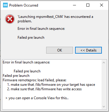

I'm using a custom buildroot build (2021.11) with linux 5.15.13, on the stm32mp157f-ev1 board.
I can load an .elf M4 firmware into the M4 core and start it, using /sys/class/remoteproc/remoteproc0
However, I can't use the debugging feature of STM32CubeIDE. I get an error in "final launch sequence".
It works fine when I'm running the standard ST linux distribution however.
Does anybody know, what is required for CubeIDE debugging to work on the M4 core in production mode?
I notice some ST stuff missing from linux 5.15.13, compared to the 5.10.61 linux used in the ST distribution: rproc_srm_core, rproc_srm_dev, tee_remoteproc, rpmsg_tty. Any of this required for CubeIDE debugging?

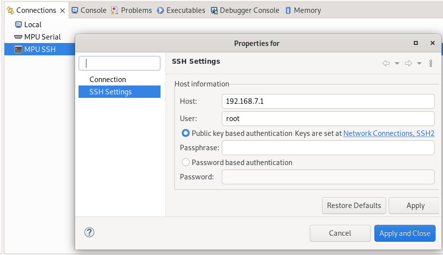

Olivier GALLIEN
Hi @MSven.2​ ,
ok ifconfig format looks good and CubeIDE might not have problem to grep the Ip address.
You should get green light and address on bottom right corner ( serial target widget ) right ?
0693W00000JOxgoQAD.pngsftp good track to follow ..
It's a core service on Yocto side .. I don't know for buildroot.
Olivier

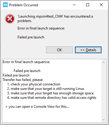

Hi @Community member​ ,
Thanks, I got a bit further now.
I included sftp server in my target build, and now CubeIDE actually transfers the .elf file to the target, in /usr/local/projects/my_project_name.
However, I then get another error:
The m4 program does not start.
But, if I manually run the fw_cortex_m4.sh shellscript that CubeIDE made in /usr/local/projects/my_project_name, it works fine and runs the m4 program (after a "chmod o+x" to make it executable).

LudovicR
Hello @MSven.2​
I understand you have updated your target device with sftp-server so you are able to browse it from an xterm of you Linux PC with "sftp root@192.168.7.1".
Could you please open connections inside STM32CubeIDE using menu:
Window > Show View > Otrhers.. Connections > Connections
and check if "MPU SSH" is present
If not please add it, with New Connection icon.
You should be able to open this connection, and Open Command Shell.
Then, you can try to debug production mode.
Hope this help,
LudovicR
