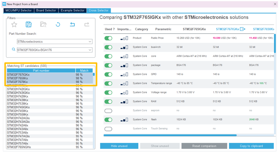

Step 7. Below the Part Number Search section, you will see a list of other comparable STM32 part numbers and their similarities in terms of a match percentage.
![1080.png 1080.png](/t5/image/serverpage/image-id/1180i73DDAA519644F7CB/image-size/large?v=v2&px=999)
On the left-hand side of the Part Number Search and Matching ST Candidates sections, you will see a chart comparing the STM32 part number you’ve selected with it’s similar STM32 part number candidates. In this chart, you will find details and comparisons between the various features pertaining to each unique STM32.
![1081.png 1081.png](/t5/image/serverpage/image-id/1179iEB89A99F0F674284/image-size/large?v=v2&px=999)
This chart is dynamic, so you can include or exclude certain features that are important to you and your use case. To do so, simply toggle the button under the “Used?” category.
![1082.png 1082.png](/t5/image/serverpage/image-id/1184i911AB5FE76551F21/image-size/large?v=v2&px=999)
By default, the top three similar part numbers are selected for comparison. However, you also have the ability to do a comparison to other STM32 part numbers with less of a percentage match. To do so, select and highlight one or more part numbers you’d like to see comparisons for.
![1083.png 1083.png](/t5/image/serverpage/image-id/1181i6E49D4DE26B4A9C3/image-size/large?v=v2&px=999)
Step 8. Make note of the top 3 matching ST candidates. In this case, the part numbers closest to our selected STM32F765IGK6 are:
- STM32F767IGKx
- STM32F765IIKx
- STM32F767IIKx
Step 9. With these comparable STM32 part numbers handy, repeat step 2. Once again, we will select the board selector tab and enter in the STM32 part number “F767” which is the first match on Matching ST candidates list from the previous step.
