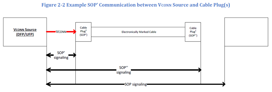

VCONN is a dedicated power supply pin in the USB Type-C® connector. It provides power to the cables electronics, such as e-markers (EMC), long cables with data repeaters, and VCONN-powered USB devices. It ensures proper power supply to these components in specific scenarios.
On the connector, one CC line performs the attachment, orientation, and power delivery communication, the other CC line can be used to power the attached cable. The valid VCONN voltage range is 3.0 V – 5.5 V.
It is a USB Power Delivery communication with Start of Packet (SOP) for source to sink signaling and SOP’/SOP ’' for cable addressing.
USB-IF: USB Power Delivery Specification, Revision 3.2, Version 1.1, 2024-10, page 58
