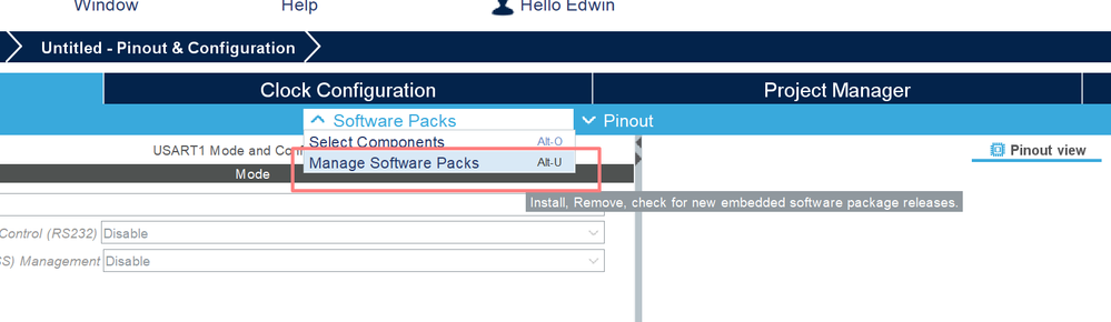

  1. From the dropdown menu in the software packs tab, select "Manage Software Packs".
  2. In the "Software Packages Manager" window, scroll down to find the FreeRTOS extension pack.
  3. Select it and install.

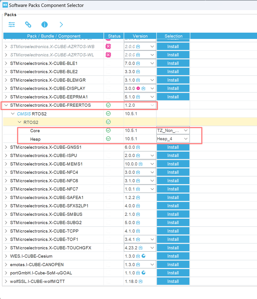

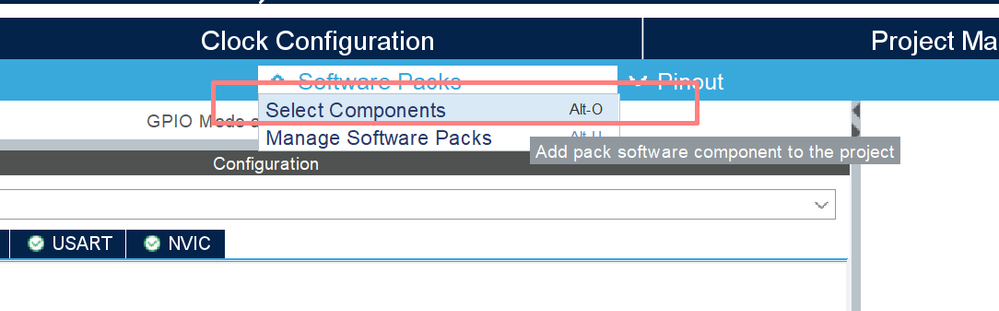

1.2. Add the new FreeRTOS component to the project
  1. Go to the dropdown menu in the software packs tab and select "Select Components".
  2. Scroll down to find the FreeRTOS component. Enable the core and select a heap scheme (Heap 4 is used in this guide).
You can read more about FreeRTOS memory management schemes here: FreeRTOS memory management.

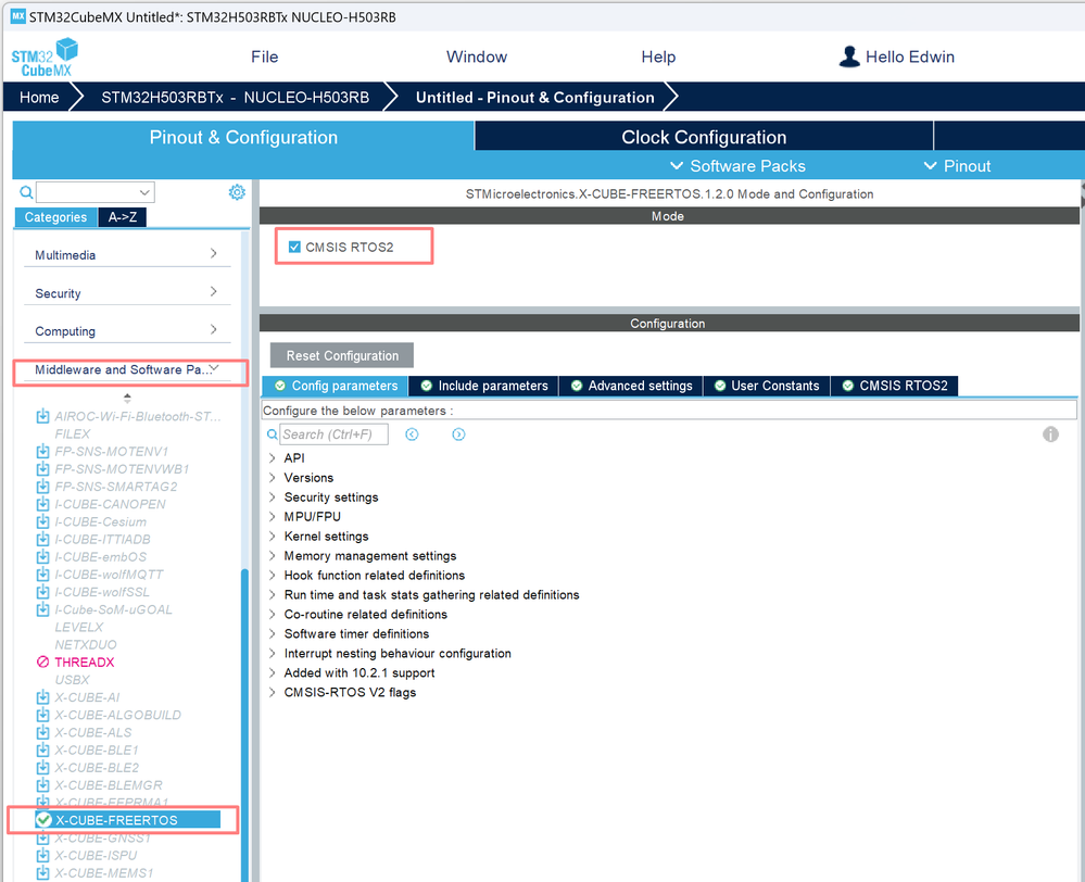

1.3. Enable and configure FreeRTOS middleware
Now that the software pack is available, add it to the project from the "Middleware and Software Packs" section of the configurator and enable CMSIS RTOS2. Note that CMSIS RTOS are just wrapper functions for FreeRTOS, and you can still call the native FreeRTOS functions.

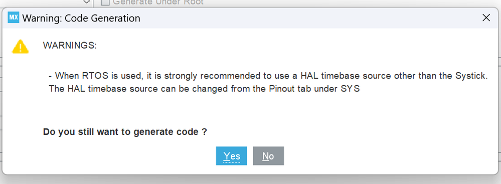

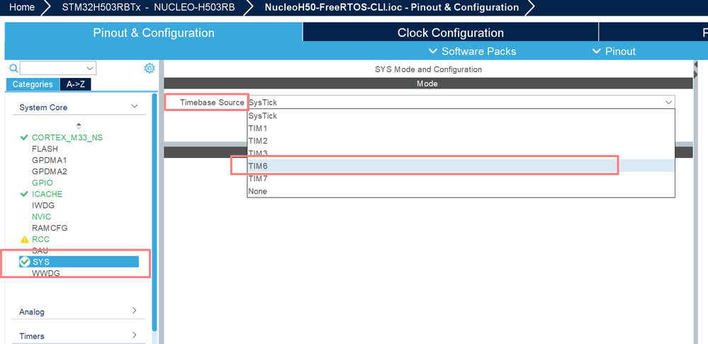

1.4. Change HAL timebase
To avoid warnings, change the clock that HAL uses for its tick timebase. Choose a basic timer on your MCU; timer 6 is used in this guide.

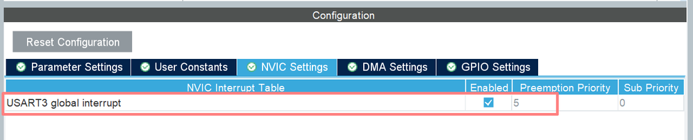

1.5. Configure UART for VCP with global interrupt
Configure USART for VCP according to your board's user manual. On the Nucleo-H503RB, this is USART 3. Enable the global USART interrupt to parse the Rx stream and verify it is enabled on the NVIC line. Consult the user manual for your specific board to find what USART is used for VCP.

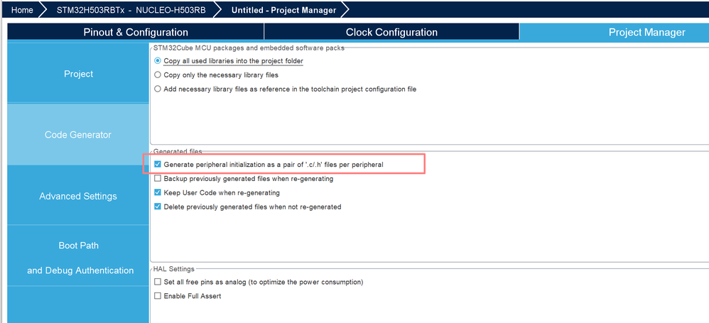

1.6. Configure project settings and generate code
Configure your project settings in the project manager according to your preferences and application needs. This guide enables the generation of c/h file pairs for each peripheral used. Generate the code and open it in your IDE or editor of choice.

We have registered the new CLI task with FreeRTOS and made our USART interrupt notify the CLI task of a new character. The USART is made ready to receive a character before our kernel starts, optionally this could be done at the start of our CLI task.
A max number of characters for the CLI output buffer was defined in FreeRTOSConfig.h
At this point, the application can be flashed and run on the MCU. Open up a terminal emulator/COM port viewer and interact with your CLI.
