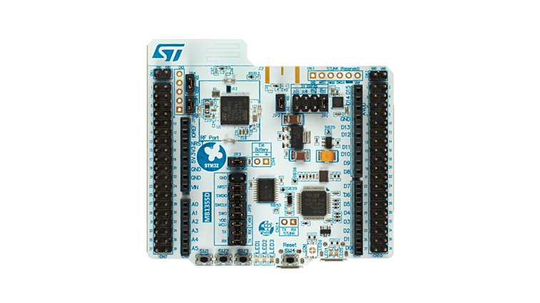

A NUCLEO-WB55RG that has an on-board ST-LINK/V2-1:

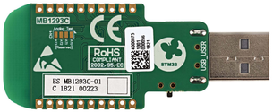

WB55CG USB dongle:

First, you have to power the USB dongle through the USB_USER port. Select the position 0 for the SW2. Finally, follow the table below to connect the ST-LINK and USB dongle:
NUCLEO-WB55RG (JP5-ST-Link pins on the right of the board)  WB55CG USB dongle (Connector CN1)
GND GND
NRST NRST
SWDIO PA13
SWCLK PA14
SWO PB3
T_VDD +3V3
