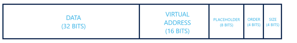

To get around the 64-bit restriction, the proposed algorithm implements multiple functions that compact different sizes of variables in a 32-bit block. For example, combining two 16-bit numbers into one 32-bit variable. The remaining 32 bits are used to store the organization data, important for verification and information retrieval.
The complete organization of the 64-bit block is described below:
  1. The first 32 bits are used to store the saved data (DATA).
  2. The following 16 bits stores a virtual address number that can be used to retrieve the data from the block (VIRTUAL ADDRESS).
  3. The next 8 bits are empty (PLACEHOLDER).
  4. The last 8 bits are divided into two functions:
  • The initial 4-bits space is used for the algorithm to interpret the placement of variables in memory (ORDER).
  • The last 4 bits store the number of different variables inside the DATA section (SIZE).
The illustration below is a visual representation of the 64-bits organization that this algorithm creates.

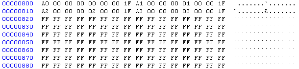

I found this nice liteweight EEPROM emulation model and I'm trying to adopt this to L476RG series. It works however in a bit strange way. When I try to write some short series of data to the flash I have something like that:
Test 1: (first page = 510, start address 0x80FF000, Init only, no write of data except id bytes={0xA0, 0xA1, 0xA2, 0xA3})
It looks ok (don't be surpsised by the offset =800 as I have set the origin for reading the flash equal one page before 510)

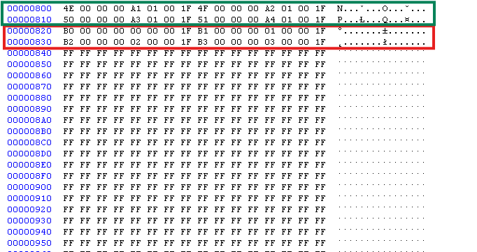

Next I've requested writing some number of data and it still looks fine ( I've requested the write of four sequences with assigning numbers 78,78,80,81 to consecutive virtual addresses 0x01A1, 0x01A2...0x01A4)

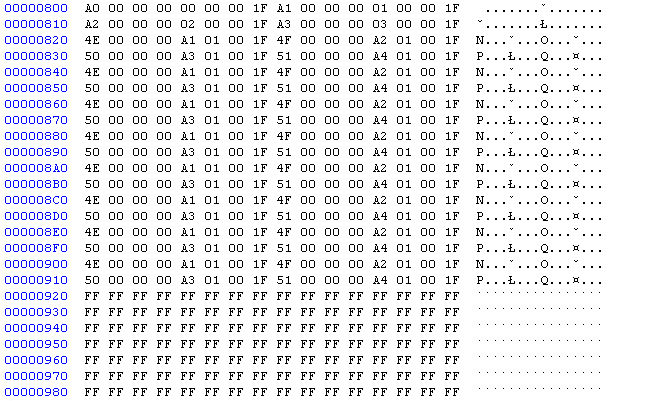

Test 2: I wanted to reinit the flash EE with new init data (B0, B1, B2, B3, and of course both pages should be cleared during this. The result was very strange, as init data were written with 32 bytes offset - red box. When I was trying to write some "user data"  - green box - it started from the beginning of the page 510 (as the init data were located with this strange offset). As You can see only half of the sequence was written, because we can't overwrite already writen data (init data)).
Is there a logical explanation for this strange offset for page? It works the same way when I change the page to the 2 last pages in the block1 - the first init works fine, but any next init may create this strange offset. It's completely random - when I'll repeat it 3-4 times, then sometimes init data are writen correctly, but most of the time - not.

Hello @marma,
I was able to reproduce the results from Test2, this "offset" seems to be caused by the STM32L476RG FLASH data cache, which, if not disabled can cause data misbehavior during the erase operations. To disable the DCACHE, add the following line of code before any flash operation begin:
CLEAR_BIT(FLASH->ACR, FLASH_ACR_DCEN)
In addition, I recommend checking the STM32L47xxx - Reference manual Embedded Flash memory section (page 96) and the Flash_EraseProgram example for STM32L476RG (STM32CubeL4/Projects/NUCLEO-L476RG/Examples/FLASH/FLASH_EraseProgram at master · STMicroelectronics/STM32CubeL4). Since this article example is designed for a minimal configuration in STM32C0 other series may require specific adjustments to work as expected.
