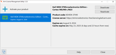

HelmPeter99
unfortunately I’m running into licensing issues when trying to use Compiler 5:
*** Warning: The configured compiler version '5.06 update 7 (build 960)' does not support the selected User Based Licensing technology.
Isn’t the compiler covered by the license server?
