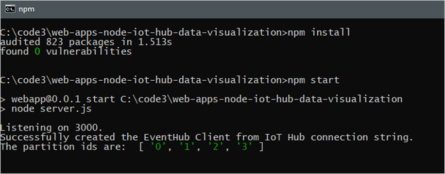

6. Run the web app
  1. Make sure that your device is running and sending data.
  2. In the command window, run the following lines to download and install referenced packages and start the website:
Cmd
npm install
npm start
  1. You should see output in the console that indicates that the web app has successfully connected to your IoT hub and is listening on port 3000

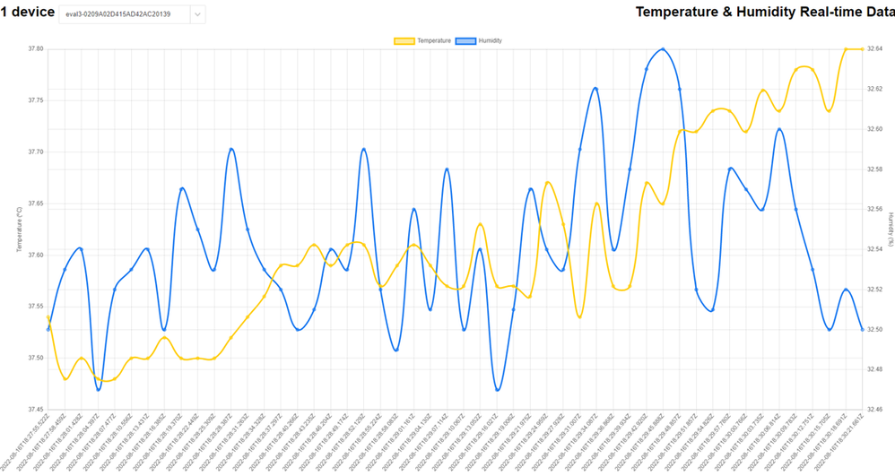

7. Open a web page to see data from your IoT hub
Open a browser to http://localhost:3000.
In the Select a device list, select your device to see a running plot of the last 50 temperature and humidity data points sent by the device to your IoT hub.
