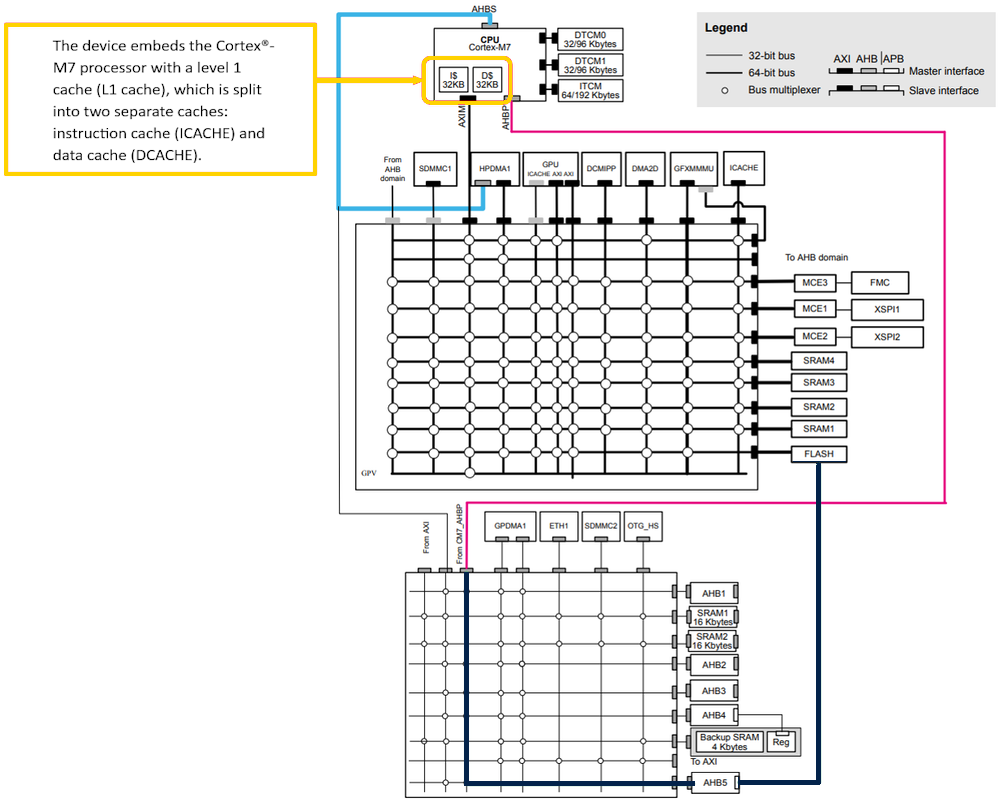

High-performance STM32 MCUs, which includes STM32F7, STM32H7, STM32N6, offer substantial performance gains, largely attributed to their integrated level 1 (L1) ICACHE and DCACHE. These caches minimize memory latency by storing frequently used instruction and data close to the CPU. However, this performance enhancement introduces a critical challenge known as cache coherency, especially in systems where multiple bus masters, such as the CPU and DMA controllers, access the same memory regions.
Figure 1. STM32H7Rx/7Sx system architecture, AN6062Figure 1. STM32H7Rx/7Sx system architecture, AN6062
1. Understanding cache and the coherency problem
  • Instruction cache (ICACHE): Stores recently fetched instructions. Speeds up code execution, especially loops.
  • Data cache (DCACHE): Stores recently accessed data. Accelerates data reads and writes. STM32 typically uses a write-back policy by default for cached SRAM, meaning writes might only update the cache initially, not the underlying RAM immediately.
Cache coherency issues arise when the view of memory differs between masters.
