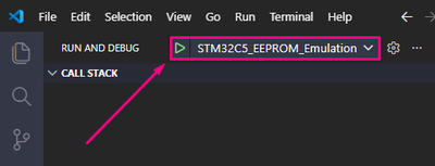

  • Show how to use the EEPROM emulation Visual Studio Code example, which is a complete project based on Visual Studio Code, CMake, and GCC. This example does not rely on STM32CubeMX2 code generation; instead, it is provided as a ready-to-build reference that can be run on a NUCLEO-C562RE board to observe driver behavior in a real application.
The sections below will help you understand the structure of the example. You will learn how to configure and initialize EEPROM emulation. The application manages 1,000 virtual variables by writing and reading them back. You will also see how the driver functions in an STM32C5 project.

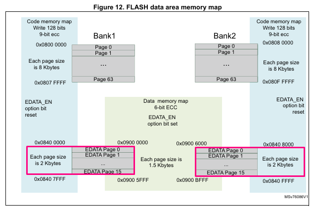

3. STM32C5 EDATA sector and option bytes
Before running the EEPROM emulation example, the STM32C5 EDATA sector must be understood and configured correctly.
EDATA sector overview
On STM32C5, the EDATA region is a dedicated 64 Kbyte FLASH sector intended for EEPROM emulation:
  • Total size: 64 Kbytes
  • Banks: 2 banks
  • Pages per bank: 16 pages
  • Page size: 2 Kbytes
This organization provides:
  • Small page size, which improves endurance and flexibility for wear leveling.
  • A dedicated region, separated from the main program FLASH, simplifying memory mapping and protection.

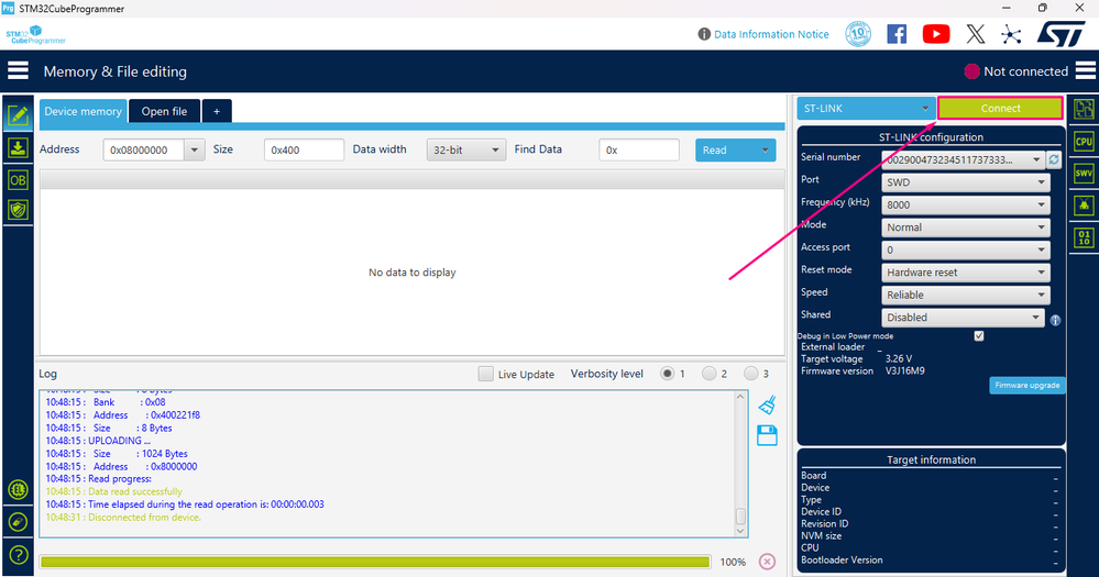

Configuring EDATA via STM32CubeProgrammer
The EDATA region is enabled and configured outside the Visual Studio Code project, using STM32CubeProgrammer:
  1. Launch STM32CubeProgrammer and connect the NUCLEO-C562RE board to the host PC using the USB Type-C® cable.
  2. Select the appropriate connection interface, then click [Connect].

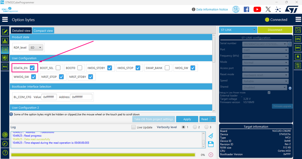

  1. Open the Option Bytes tab and enable [Compact View].
  2. In the User Configuration section:
    • Enable the EDATA (EDATA_EN) option to activate the EDATA sector for 16‑bit or 32‑bit data granularity, consistent with the EEPROM emulation driver configuration used by the example.
  1. Click [Apply] to write the option bytes and let the device reset if requested.
With EDATA correctly enabled and configured, proceed to the next section to observe the structure of the Visual Studio Code and CMake example and how it maps the EEPROM emulation driver onto this dedicated FLASH region.

4.1 Example structure and toolchain

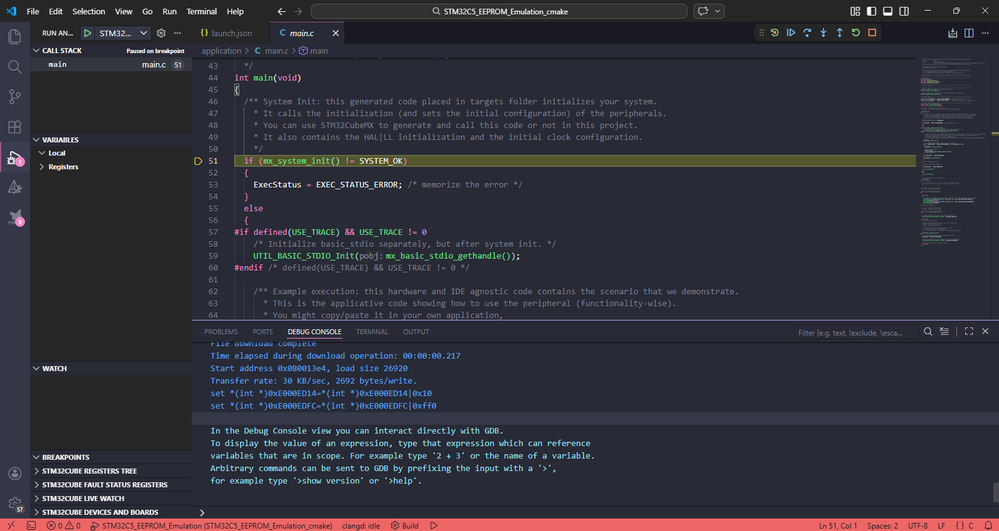

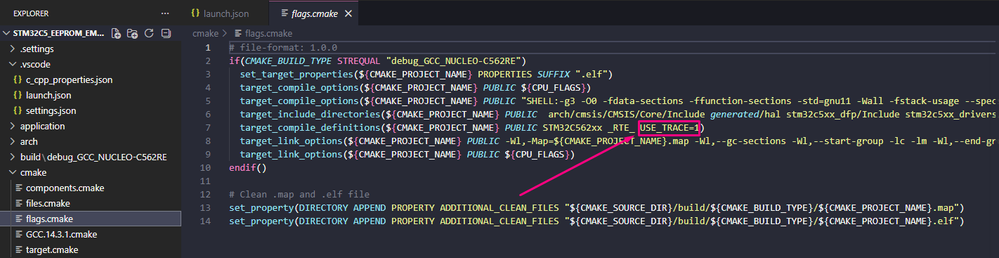

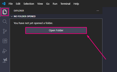

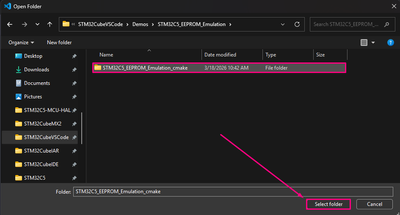

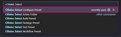

The example is provided as a ready-to-build Visual Studio Code, CMake, and GCC project. The layout is:
  • generated/hal: System and device initialization (startup, clock configuration, HAL init, mx_system_init()).
  • stm32c5xx_drivers/: STM32C5 HAL and low-level drivers.
  • utilities/eeprom_emulation/: Complete EEPROM emulation driver, split into:
    • Core API: eeprom_emul_core.c/.h
    • Algorithms: eeprom_algo_flitf.c/.h, eeprom_algo_nvm.c/.h
    • Interfaces:
      • Flash: eeprom_itf_flash.h, eeprom_itfflash_flitf_edata.c, eeprom_itfflash_nvm_edata.c, templates
      • CRC: eeprom_itf_crc.h, eeprom_itfcrc_crc.c, template
      • ECC: eeprom_itf_ecc.h, eeprom_itfecc_bch.c, template
  • eeprom_mx_config: Glue and configuration:
    • eeprom_emul_conf.h – configuration of the emulation (algorithm selection, EDATA mapping, endurance, and variable count).
    • mx_eeprom_emul.c/.h – glue tying the generic driver to STM32C5 HAL flash and CRC handles.
  • Application:
    • example.c/.h – demonstration scenario: initialization, write, cleanup, read and verify, de-initialization.
    • main.c/.h – system entry point, example loop, and LED/status reporting.
  • Build configuration:
    • CMakeLists.txt and related CMake files to drive GCC.
    • Visual Studio Code configuration files (.vscode/) to build, flash, and debug via the STM32Cube extension.

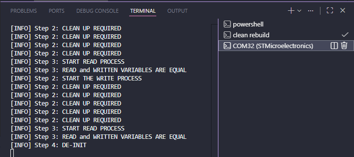

  • Step 1 – Initialization (app_init): Call mx_eeprom_emulation_init() and report success or failure.
  • Step 2 – Write all variables and handle cleanup (app_process, first part): Write 1000 8‑bit variables (IDs 1..1000) into the emulated EEPROM, handling EE_INFO_CLEANUP_REQUIRED.
  • Step 3 – Read back and verify (app_process, second part): Read all variables back and compare with the original values.

  • Launch Visual Studio Code.
  • Select Open Folder.
  • Browse to and select the root folder of the EEPROM Emulation project.
  • Click Select folder to load the project into VS Code.
  • Press Ctrl+Shift+P and [CMake: Select Configure Preset].
  • Select [debug_GCC_NUCLEO_C562RE].
  • Press Ctrl+Shift+B to trigger the [CMake: clean rebuild] task

The project provides a launch.json file with a debug configuration named STM32C5_EEPROM_Emulation, based on the STM32Cube ST-LINK GDB server. You do not need to create or modify it; just select and use it.
  1. Open the Run and Debug view
    • Press Ctrl+Shift+D (Run and Debug) in VS Code.
    • In the configuration drop‑down, select:
  2. Start debugging
    • Connect the NUCLEO‑C562RE board to your PC via USB Type-C® (ST‑LINK).
    • With STM32C5_EEPROM_Emulation selected, press F5 or click Start Debugging.
  • The debugger launches the ST‑LINK GDB server and start your application.
  • Execution halts at main().

Stepping through the EEPROM Emulation example
To understand and validate the EEPROM emulation flow, set breakpoints in the key functions:
  • Initialization path
    • main() – the overall control flow (mx_system_init(), app_init(), loop).
    • app_init() – calls mx_eeprom_emulation_init() and reports init status.
    • mx_eeprom_emulation_init() – calls EE_Init() and binds FLASH/CRC handles.
  • Write/cleanup/read path
    • app_process() – executes:
      • Step 2: write loop with EE_WriteVariable8bits().
      • Handling of EE_INFO_CLEANUP_REQUIRED and EE_CleanUp().
      • Step 3: read/verify loop with EE_ReadVariable8bits().
    • Error and fault handling
      • EE_CleanUp() – to see page cleanup execution when requested.
      • HardFault_Handler() – to catch unrecoverable issues (for example, EDATA mode mismatch, ECC errors).
Run the example, single‑step or continue, and observe:
  • How often EE_INFO_CLEANUP_REQUIRED occurs.
  • That EE_ReadVariable8bits() returns the same values as written.
  • That ExecStatus transitions to EXEC_STATUS_OK at the end of a successful pass.
Validating behavior (logs and LED)
With the debugger running:
  • Console logs (if USE_TRACE=1)
In the serial/ITM output, you should see:
  • [INFO] Step 1: EEPROM INITIALIZATION COMPLETED.
  • [INFO] Step 2: START THE WRITE PROCESS
  • Optionally [INFO] Step 2: CLEAN UP REQUIRED when cleanup is triggered
  • [INFO] Step 3: START READ PROCESS
  • [INFO] Step 3: READ and WRITTEN VARIABLES ARE EQUAL
Any [ERROR] message indicates where the scenario failed (init, write, read, or comparison).

    • Check EDATA option bytes in STM32CubeProgrammer (EDATA_EN enabled, granularity matches the driver).
