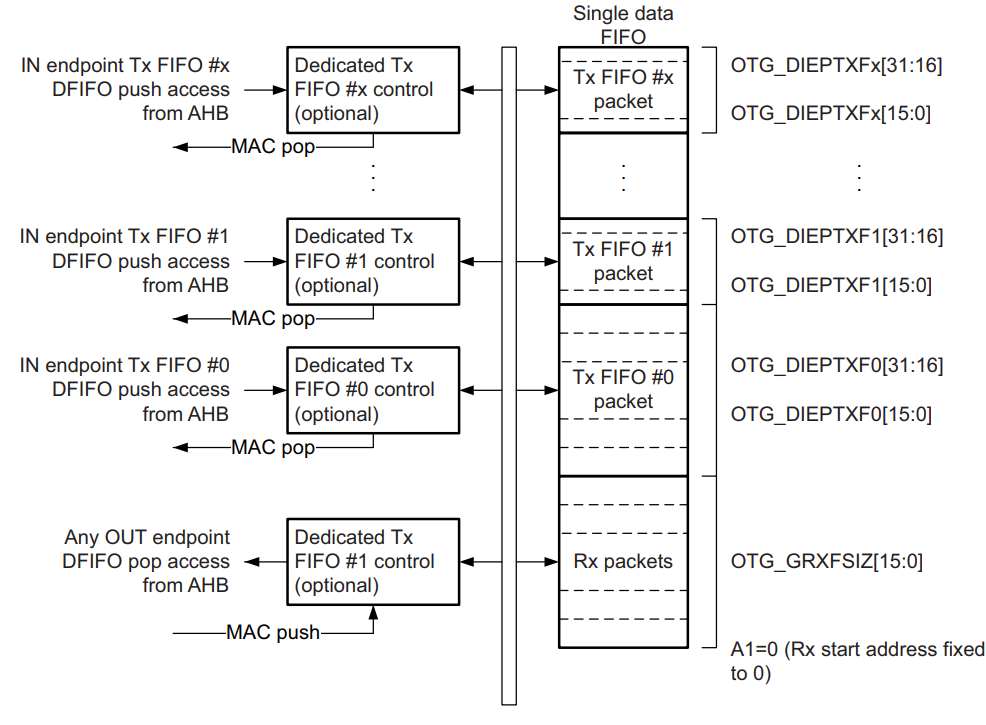

5. Explanation of FIFO operations in device mode in STM32 USB communication
Generally, FIFO sizes can be adjusted to optimize performance and reduce CPU overhead. For example, to handle more data and reduce the frequency of FIFO overflows, FIFO sizes should be larger in high speed mode. Also, bulk endpoints might require larger FIFOs to handle large data transfers efficiently compared to different types of endpoints.
Refer to the appropriate STM32 datasheet to check the size of dedicated FIFO SRAM. Furthermore, check if double buffer mode is supported, which would reduce the number of available endpoints. Here’s how USB FIFO is managed:
  • Rx FIFO: A single shared FIFO for all OUT endpoints, configured via OTG_GRXFSIZ. Efficiently handles incoming data, with status and data stored together. Generates interrupts when full or when data is available.
  • Tx FIFOs: Dedicated FIFOs for each IN endpoint, with sizes configured via specific registers (OTG_DIEPTXF0 and OTG_DIEPTXFx).
Proper management of FIFO sizes ensures efficient data transmission and reception without overflow. By configuring FIFO sizes appropriately, you can enhance the performance and reliability of your USB communication.
