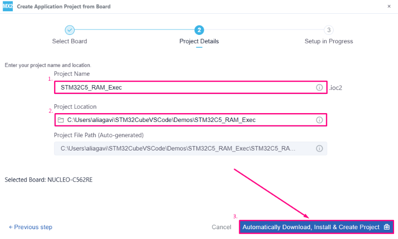

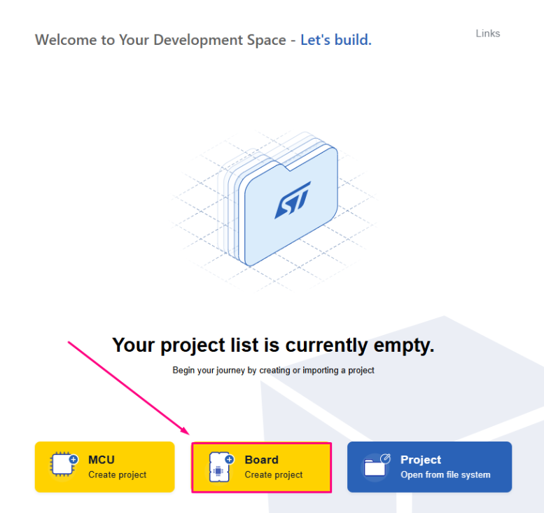

2. Creating the STM32CubeMX2 project (NUCLEO-C562RE)
Start STM32CubeMX2 and create a new project. In the Board Selector, choose: NUCLEO-C562RE.

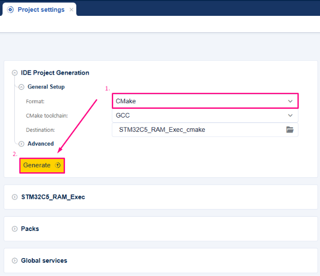

Keep all the STM32CubeMX2 configuration to the default and go to Project settings → Format:
  • Select CMake
  • Click Generate Code.
STM32CubeMX2 creates a directory containing:

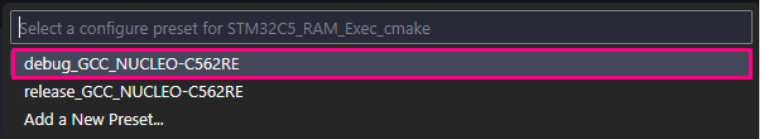

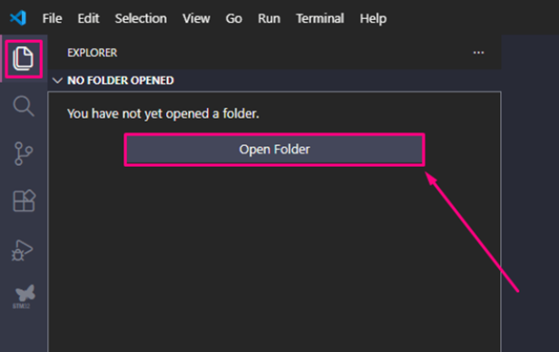

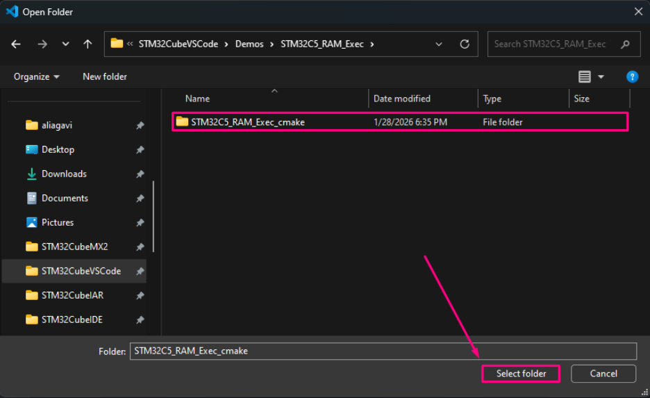

  • Launch Visual Studio Code.
  • Select [Open Folder].
  • Browse to and select the root folder of your generated STM32CubeMX2 project.
  • Click Select folder to load the project into VS Code.

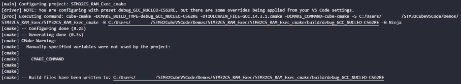

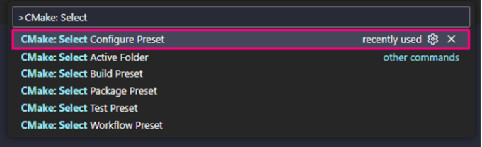

  • Press Ctrl+Shift+P and [CMake: Select Configure Preset].
  • Select [debug_GCC_NUCLEO_C562RE].

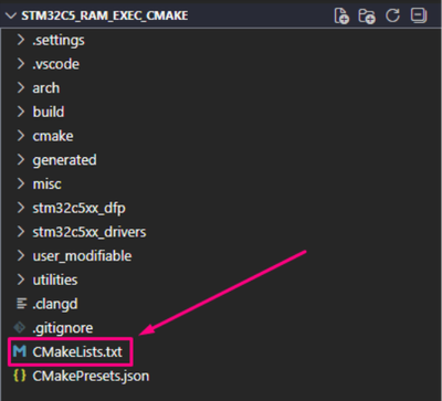

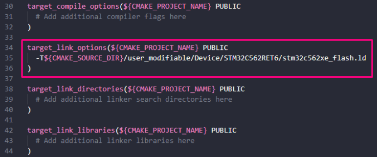

Modify your CMakeLists.txt to specify explicitly the linker to be used.
  • Open the CMakeLists.txt
  • In target_link_options add:
-T${CMAKE_SOURCE_DIR}/user_modifiable/Device/STM32C562RET6/stm32c562xe_flash.ld
  • Ctrl+S to save and configure

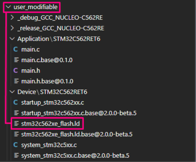

5.2 Adjust (or verify) the linker script

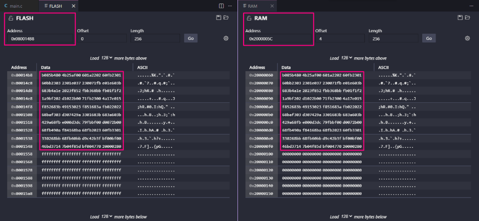

In user_modifiable\Device\STM32C562RET6 open the file stm32c562xe_flash.ld and locate the .data section.
Many recent STM32Cube templates already include a .RamFunc output section, sometimes separate from .data, but verify or add it:
/* Initialized data sections into "RAM" Ram type memory */
 .data :
 _sdata = .; /* .data sections */
 *(.data); /* .data* sections */
 *(.data*);
 . = ALIGN(8);
 /* Functions to be executed from SRAM */
 *(.RamFunc)
 *(.RamFunc*)
 _edata = .; /* end of .data in RAM */
 } > RAM AT> ROM
Key points:
  • The entire .data (including .RamFunc) is stored in FLASH (ROM) and copied to RAM at startup.
  • The default STM32 startup code already performs this copy; no additional code is needed.

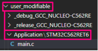

Open user_modifiable/Application/STM32C62RET6/main.c.
Prototype and attribute
main.c file, add:

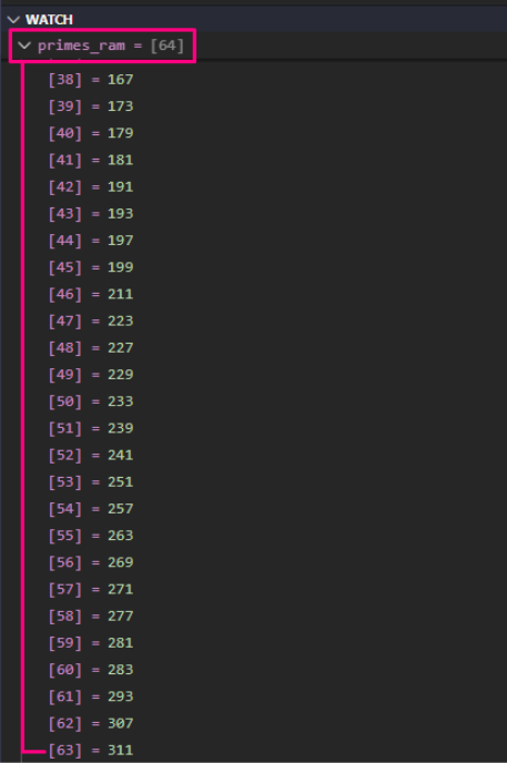

After running, you can inspect primes_ram[] in the debugger to confirm it holds prime numbers.

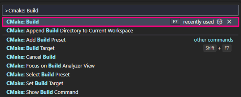

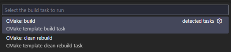

Build the project:
  • Press Ctrl+Shift+B to trigger the default build task, or
Open the Command Palette (Ctrl+Shift+P / Cmd+Shift+P) and run [CMake: Build] or press F7.
The build output appears in the terminal panel, showing compilation progress and any errors or warnings.

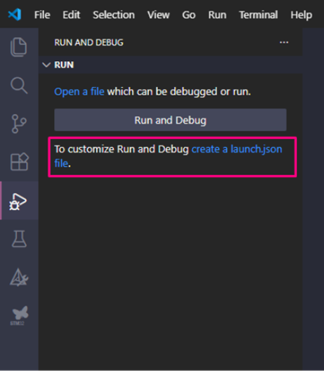

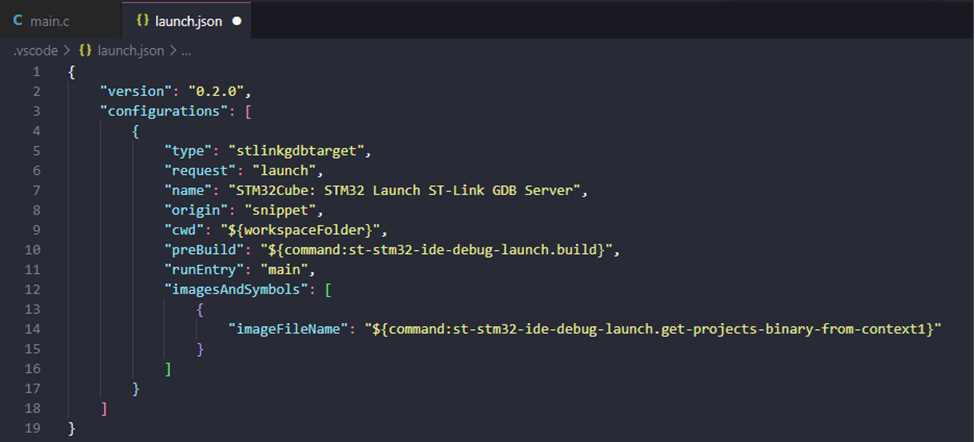

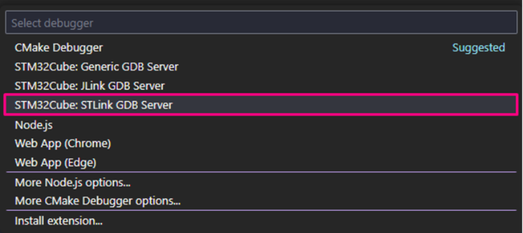

Debug the application:
  • Open the [Run and Debug] panel (Ctrl+Shift+D).
  • Create a new debug configuration by clicking [create a launch.json file.]
  • Select [STM32Cube: STLink GDB Server].
This generates a launch.json file configured for your STM32 project.
  • Start the debug session by pressing F5 or clicking the green [Start Debugging] button.

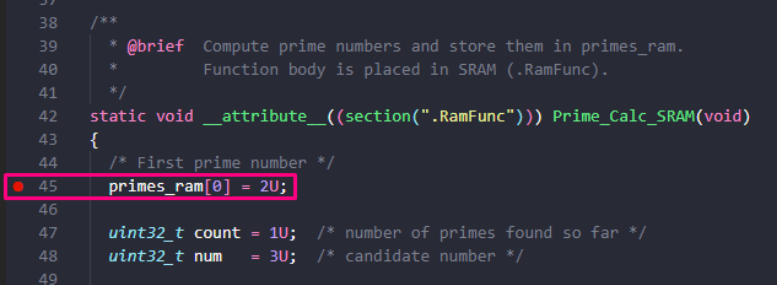

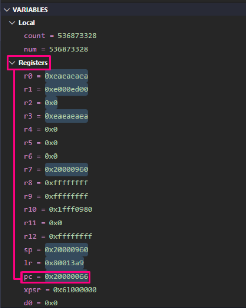

To confirm that Prime_Calc_SRAM() is executed from SRAM:
  • Set a breakpoint on the first line of Prime_Calc_SRAM().

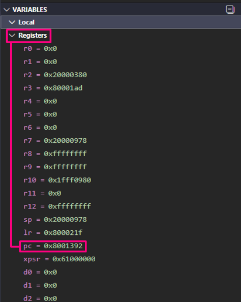

  • In Variables, open the Registers view.
  • Let the program run until it hits the breakpoint.
  • Check the Program Counter (PC) value:
    • On most STM32s, SRAM is at 0x2000xxxx.
    • If the PC is in the 0x2000xxxx range, the function is running from SRAM.
    • If it’s around 0x0800xxxx, the function is still in flash (linker/script not set correctly).
Optionally:
  • Using the command palette (Ctrl+Shift+P), run the command Memory: Show Memory Inspector and inspect the Memory at:
    • The FLASH (ROM) address where .RamFunc is stored (visible in the .map file).
    • The SRAM address where .RamFunc is copied.
You should see identical code in both locations, with the PC pointing to the SRAM region during execution.
Verify the following:
  • primes_ram[ ] contains prime numbers (for example, 2, 3, 5, 7, 11, ..., 311).
