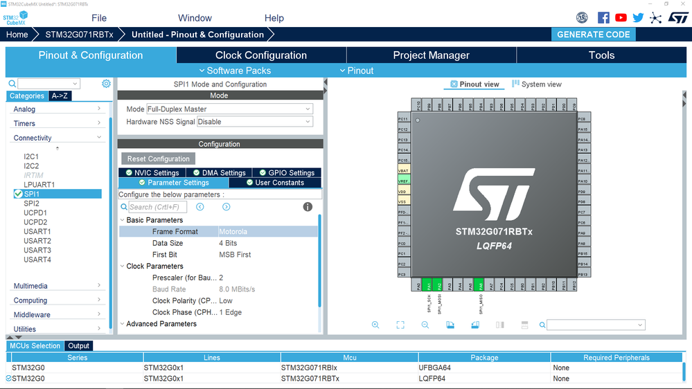

  • I have selected an STM32G071RBTx
  • I would like to remap the SPI1_SCK alternate function.
  • I am enabling SPI1 from STM32CubeMX and the tool will select default GPIOs as seen below:

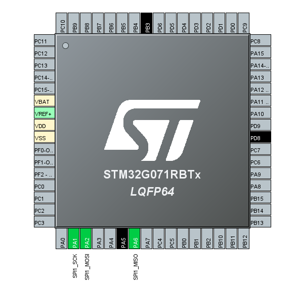

2. Remap SPI1_SCK
Let's say I would like to remap the SPI1_SCK signal to another GPIO offering the same Alternate Function.
To do this, place the mouse pointer on the pin PA1, press and hold the Control key (CTRL) and then left click the mouse. This will highlight the remapping options available, as indicated by the black background fill for the GPIO pins PA5, PB3 and PD8 (see figure below):

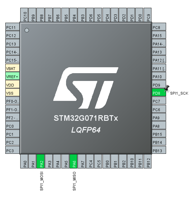

3. Practical example: remap SPI1_SCK to PD8
Let's imagine we want to remap SPI1_SCK to PD8, with CTRL and left clock still pressed you want to drag and drop from PA1 to PD8 and that will select SPI1_SCK to be configured for PD8 as show below:
Et voila!
