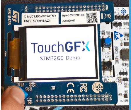

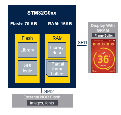

TouchGFX framework includes support for low-cost microcontroller based applications, such as the STM32G0, with a professional looking GUI (Graphical User Interface). The new partial framebuffer minimizes the RAM needed for image building using a configurable partial frame buffer size and number of partial frame buffers. Additionally, it offers smart partial screen updates for higher user interface performance and supports inexpensive external flash. All this makes for very cost-effective GUI applications.
This article shows how to load and run a TouchGFX demo on a cost-effective hardware platform to experience first-hand the quality and capability of the solution.

The memory requirements of the demo are:
  • 75 KB of internal Flash
  • 16 KB of RAM (10 KB for Library data and 6 KB for the partial frame buffer)
  • External NOR Flash

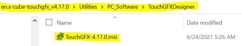

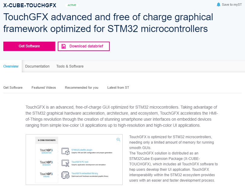

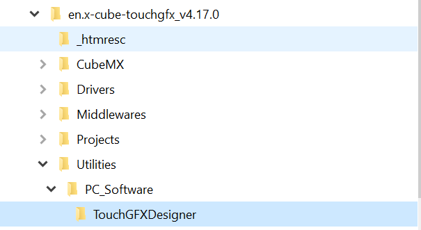

  1. From st.com download and unzip the latest X-CUBE-TOUCHGFX
  1. Install TouchGFX Designer - the installer is located here:

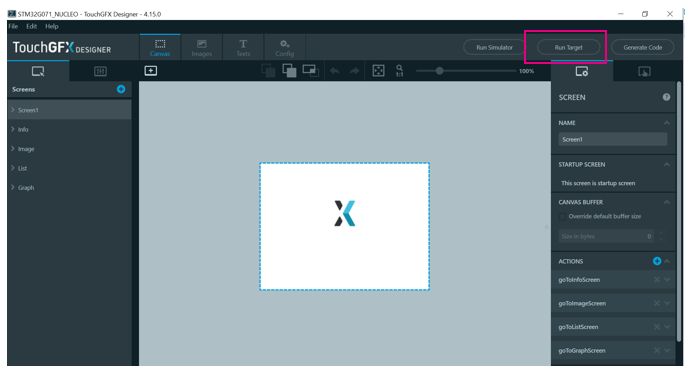

  1.  Launch TouchGFX Designer

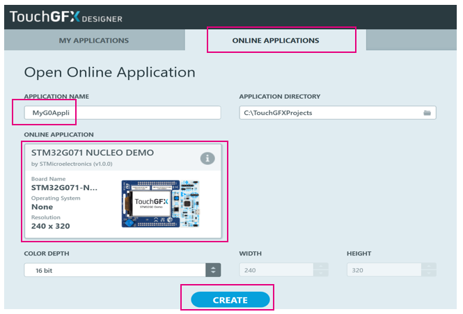

  1. In TouchGFX, create a project from ONLINE APPLICATIONS using the STM32G071 NUCLEO DEMO template.
  1. Run target
The code is programmed into the target’s on chip memory and graphic images are loaded into the external memory. Once that is complete the code is run.

  1. Explore the capabilities of this cost-effective GUI solution by using the joystick to advance through the demos
