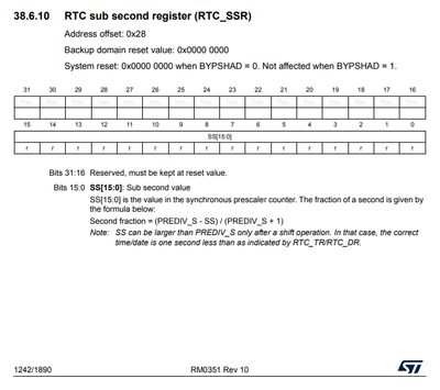

1. RTC_SSR register
The RTC’s calendar time is stored in two separate registers: RTC_TR and RTC_SSR. The RTC time register (RTC_TR) holds the hours, minutes, and seconds information for the current time-of-day. The RTC sub second register (RTC_SSR) holds the sub seconds information for the current time-of-day. The RTC_SSR register is the focus of this article.
The RTC_SSR register contains the 16-bit value SS, which represents the number of sub seconds in the current time-of-day. More specifically, the value of SS equals the number of divisions in one second at the current time-of-day.

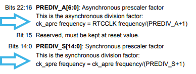

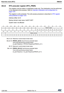

PREDIV_S is a 15-bit user-programmed value that we set in the RTC_PRER register.
For this article, we have arbitrarily chosen to use PREDIV_S = 4096. For your application, compute PREDIV_S appropriately based on your application’s requirements and the equations given in the RTC_PRER register bits description.
By our example, if PREDIV_S = 4096, then we can divide 1 second a maximum of 4096 + 1 times.
For example: 1 second = (4097 divisions / 4097 divisions per second)

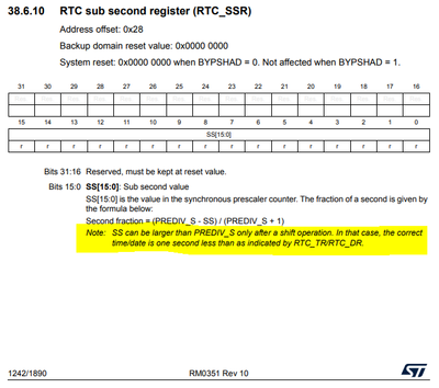

By this logic, (PREDIV_S + 1) is the maximum number of sub seconds we can have in 1 second. Therefore, SS will typically be a value between 0 and PREDIV_S + 1.
As noted in the reference manual, SS can be a value greater than PREDIV_S only when a shift operation is performed to try and synchronize the RTC with a remote clock.

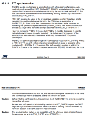

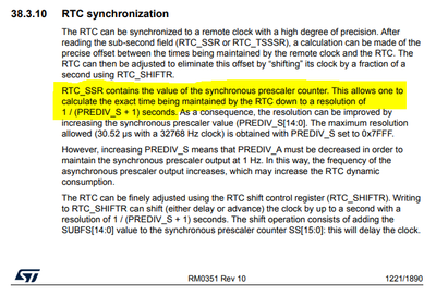

For more details on RTC synchronization, refer to the reference manual for your specific STM32 part number. For STM32L476xx MCUs, RM0351 section 38.3.10 discusses RTC synchronization in detail.

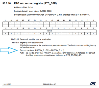

3. Second fraction equation
The Second fraction is an equation given in the reference manual and can be found in the section for the RTC_SSR register.
The Second fraction equation uses the RTC’s sub second value (SS) to compute the number of fractions of a second in the current time-of-day.
In simpler terms, the Second fraction equation converts the RTC’s raw sub second value (SS) into fractions of a second, which is generally a more meaningful way to interpret the value.
