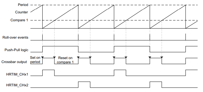

1.1 Push-pull mode

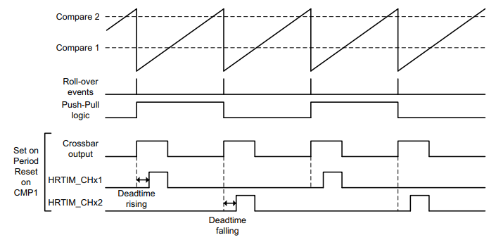

The push-pull logic in this mode exhibits an alternating pattern, transitioning between low and high states on each timer period. This necessitates the use of two output channels, as only one channel is active during each state. This mode is available when the timer either operates in continuous mode or in single shot mode.
The figure below from RM0440 page 909 showcases the working of push-pull mode.
1.2 Deadtime in push-pull mode
In the context of push-pull configurations in HRTIM, dead time refers to a deliberate delay introduced between the deactivation of one output signal and the activation of the other. By intentionally introducing a short delay between the deactivation of one output and the activation of the other, dead time ensures that both outputs are never active at the same time.
The figure below from RM0440 page 910 shows the working of push-pull mode with a positive value of deadtime configured.Lionking_2-1738180199569.png

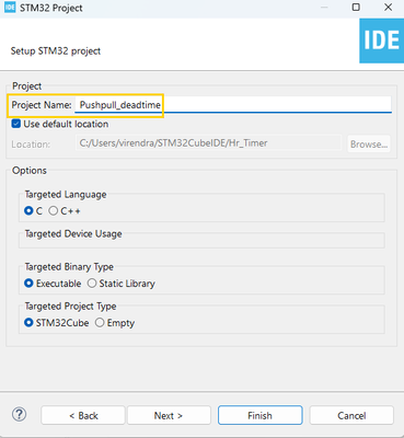

1.3 Project configuration

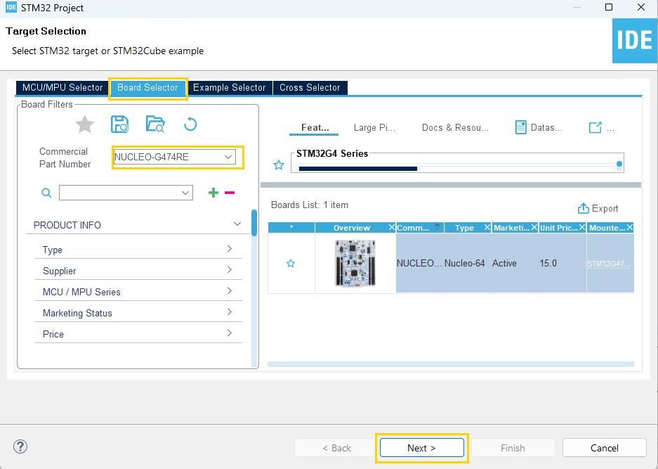

We start this demonstration by creating a new project for the NUCLEO-G474RE discovery board using STM32CubeIDE, configuring the clocks and the HRTIM peripheral. Here are the steps to perform the initial configurations.
  • Open the STM32CubeIDE application
  • Choose [File] -> [New] -> [STM32 Project]
  • Search for NUCLEO-G474RE under board selector tab and click on the shown board selection and then click [Next].
Choose a name for the project and click on [Finish].

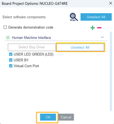

Upon the display of the "Board Project Options" dialog box, select the [Unselect All] option as we are not utilizing these software components. Click the [OK] button.

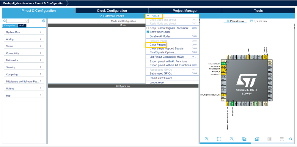

Laurids_PETERSEN_2-1744716747968.pngOnce the .ioc file is open, click on [Clear Pinouts] under the [Pinout & Configuration] drop-down menu to start the peripheral initialization from scratch.

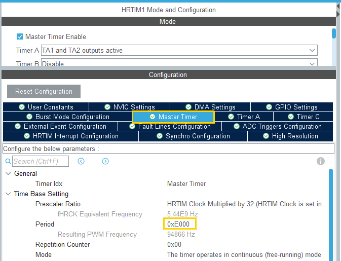

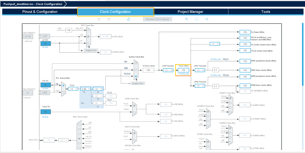

Navigate to the clock configuration settings and ensure that the APB2 peripheral clocks, which the HRTIM is connected to, is set to run at 170 MHz.

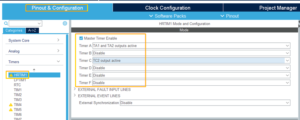

1.4 HRTIM configuration

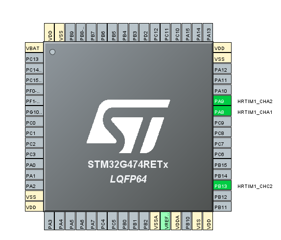

In the "Pinout & Configuration" tab, navigate to the timers dropdown menu. Select [HRTIM1] and enable the Master Timer, Timer A1, Timer A2, and Timer C TC2 outputs.
By doing this, pins PA8 and PA9 are configured to serve as Output Channel 1 and 2 for Timer A and PB13 for Output channel 2 of Timer C
NOTE: The master timer does not have any output pins.

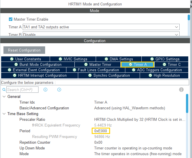

1.4.2 Clock configuration
The HRTIM can be clocked at a maximum clock of 170 MHz using the APB2 bus.

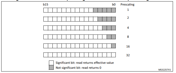

It supports clock prescalers that can multiply the APB clock value by 1, 2, 4, 8, 16, or 32, or divide the APB clock value by 2 or 4. Therefore, the maximum fHRTIM clock achievable is 5.44 GHz when using a multiplication prescaler of 32 with an APB2 base clock of 170 MHz. Conversely, the lowest frequency attainable, given an APB2 clock of 170 MHz, is 42.5 MHz when using a prescaler divider of 4.
The maximum value that the period register can support varies when using multiplication prescaler values, as the least significant bits become insignificant.Lionking_0-1738105874195.png
The maximum programmable period values for each multiplication factor are shown in the table below.

By selecting a multiplier prescaler of 32, the maximum period value is 0xFFDF. We use the period value as 0xE000 which results in the PWM frequency of fHRCK / Configured_period_value = 5.44 GHz / 0xE000 = 94866 Hz. For simplicity, we use the same clock configuration for all the enabled timers. The changes to be done under the HRTIM configuration sections for the timers are shown below:
With the clock configurations complete, let us proceed to configure the other parameters of the timers.

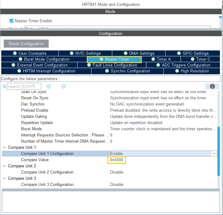

1.4.3 Master timer configuration
Enable the compare Unit 1 and configure the compare value as 0x5000

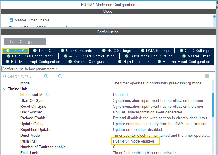

1.4.4 Timer A configuration
Under the "Timing Unit" section, enable the push pull mode.

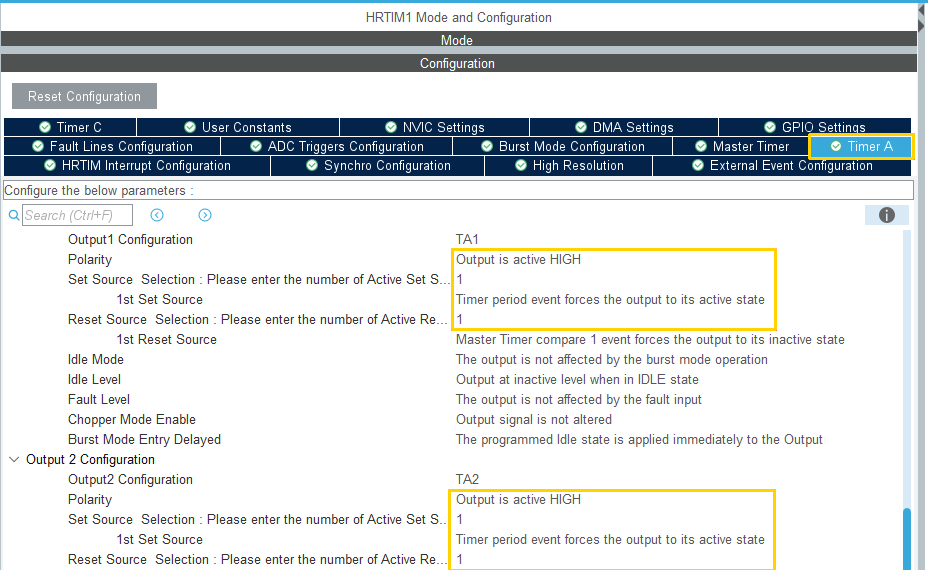

Change the number of active set and reset sources to 1.
Next, configure the set and reset events for the outputs signals TA1 and TA2, each of which becomes active on the alternating period event due to the push-pull mode.
OUTPUT Set event Reset event
TA1 Timer period Master compare unit 1
TA2 Timer period Master compare unit 1

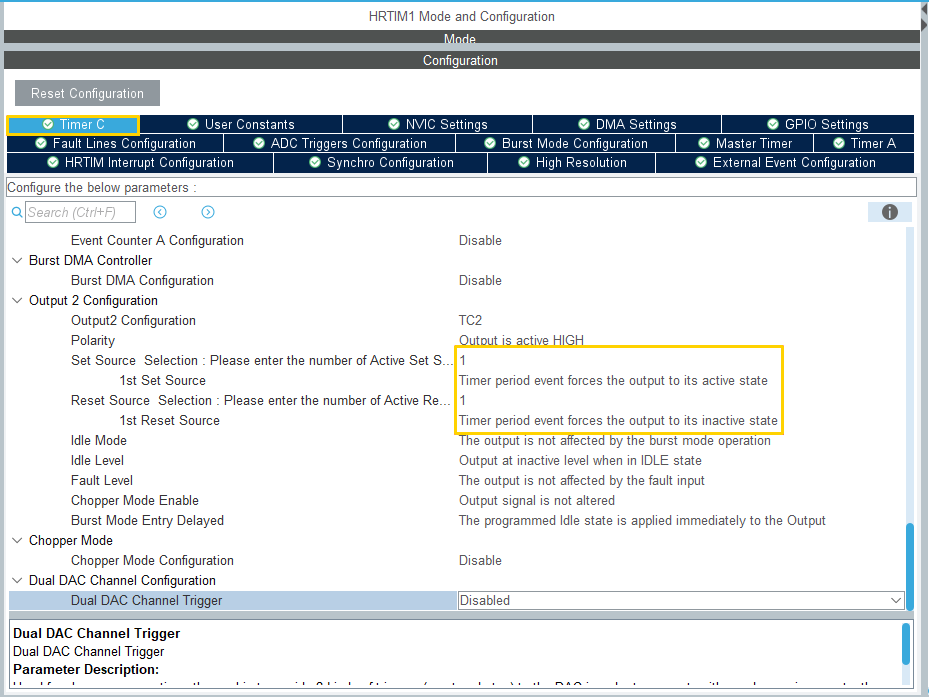

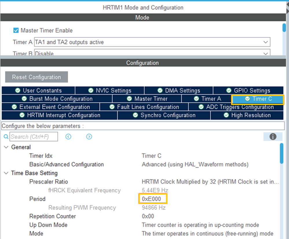

1.4.5 Timer C configuration
The output TC2 must be toggled with each period event to analyze the push-pull behavior. Therefore, configure the source of set and reset events to trigger by the timer period event.

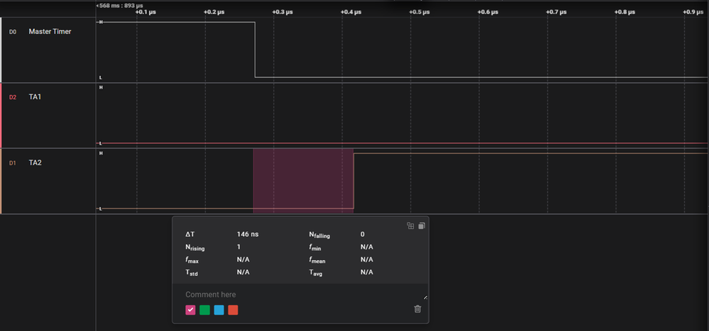

2. Results
Connect your board to the PC using a USB cable. Compile, load, and debug the binary file by clicking on the button shown below. The programming process should be complete without any errors.

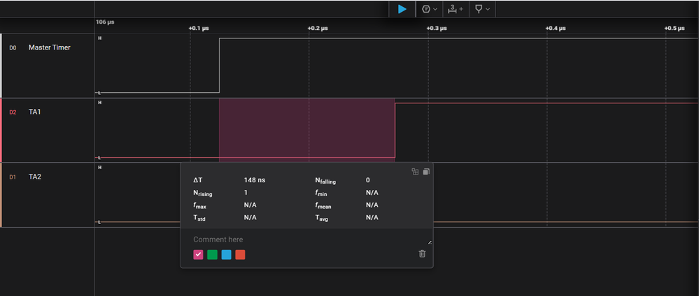

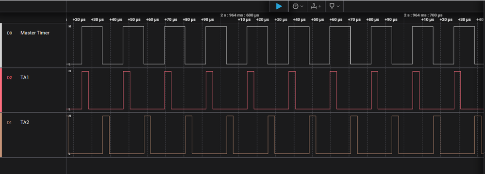

Connect the logic analyzer or oscilloscope probes to pins PA8, PA9, and PB13. Then, click on the [Run] icon to start the process.
High-level analysis of the oscilloscope captures indicates that the push-pull operation is functioning as designed. TA1 and TA2 outputs exhibit the expected alternating activity synchronized with the period events.
Zooming in on TA1 and the master timer we can see the deadtime to be 148 ns. This is an approximate of ~146 ns which we found in the calculations earlier
Subsequently, zooming in on TA2 and the master Timer we can see the deadtime to be 146 ns which verifies the push-pull mode with deadtime functionality
