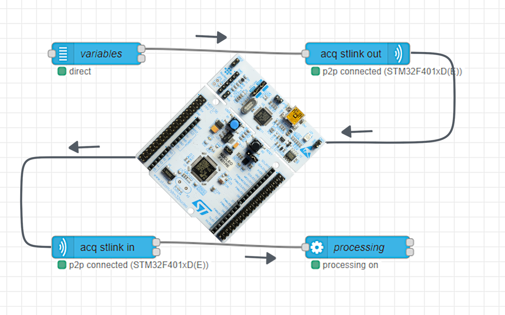

1.1 Data flow
The first link in the acquisition chain is the variables node. This node lets us choose variables to acquire and the parameters of the acquisition, for example, sampling frequency (in direct mode). This node then sends commands to the "acquisition out" node. Two versions exist, one for STLINK acq stlink out and one for J-Link acq jlink out. This article is written with STLINK but is also applicable to J-Link by replacing the acquisition nodes with J-Link ones. The acq stlink out node connects to the STLINK connected to our STM32 MCU. Once this connection is set up, we can use the acq stlink in node to retrieve the acquired data. The output of the acq stlink in node can be connected to the processing node.
Fig. 1: Data flow in STM32CubeMonitorFig. 1: Data flow in STM32CubeMonitor

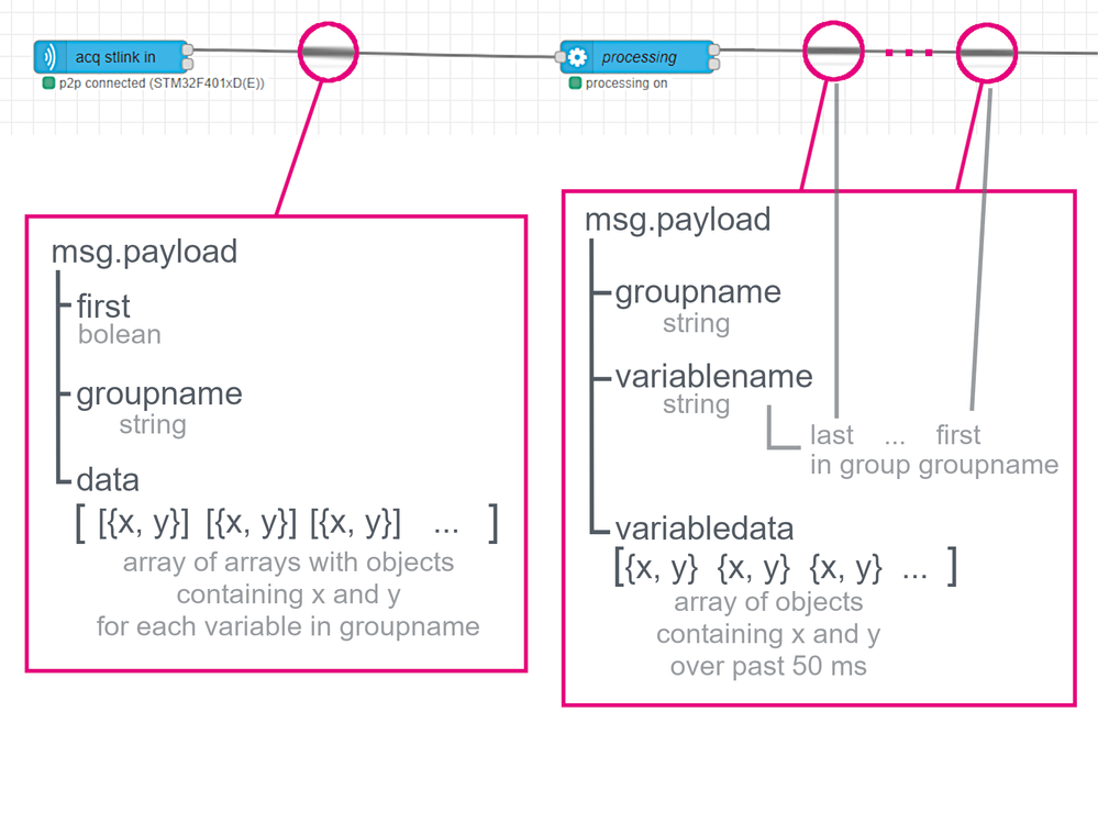

1.2 Message structure
In STM32CubeMonitor, nodes communicate via messages msg as JavaScript objects. Focusing on messages containing variable's data, the most interesting part is msg.payload. In STM32CubeMonitor, these are produced by acq stlink in and processing nodes. There is however a significant difference in the msg.payload contents output from these nodes.
1.2.1 acq stlink in node
The acq stlink in node produces the msg.payload with three fields: data, first, and groupname. The groupname field is a string of the name of the variables group defined in variables node. The first field contains a boolean value of whether the msg is the first one sent after starting acquisition. The data field is an array of arrays with the variables' measurements as objects with fields x and y, where y is the value of the variable at time x. Time x is given in ms. The order of the variables in the data field array is given by the order seen in the variables node.
1.2.2 processing node
The processing node computes the postprocessing values and reorganizes the data structure. As is apparent from above the acq stlink in node outputs message each measurement of all the variables at once. On the other hand, the processing node serializes the data somewhat by producing a separate message for each variable of measurements acquired over the last 50 ms. The variables' messages appear in the same order as the variables in the variables node.
Here the msg.payload object contains fields groupname, variablename, and variabledata. The groupname has the same contents as above. The variablename field contains a string with the name of the variable as defined in variables node. The variabledata field contains an array of objects with the same x and y fields as above. The array's length depends on the sampling frequency.
The rule of thumb is that if the sampling frequency defined in variables node is higher than 20 Hz ('sampling period' shorter than 50 ms), some arrays have length greater than 1. If the sampling frequency is lower than 20 Hz, the arrays usually have length of 1. If there was no measurement acquired in the 50 ms interval, no message is sent.
Fig. 2: Data structure after acq stlink in and processing nodesFig. 2: Data structure after acq stlink in and processing nodes

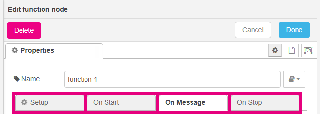

2.1 function node
The function node allows you to write your own JavaScript function that accesses the message msg contents to further process and modify them. If you are not familiar with JavaScript, don't worry. Given that you have already most likely written some C/C++ code for STM32 MCUs, you should do quite alright with your knowledge.
In STM32CubeMonitor with the node open you can see it has four tabs:
  • "Setup"
  • "On Start"
  • "On Message"
  • "On Stop"
In the "Setup" tab, you can set the number of outputs, which should equal to the number of elements you want to send. The behavior of the other tabs is straightforward. Code under the "On Start" tab runs once whenever the node is started. Similar with the code in the "On Stop" tab only now it executes when the node is stopped. The "On Message" code runs whenever the function node receives a message.
Fig. 3: Function node tabsFig. 3: Function node tabs

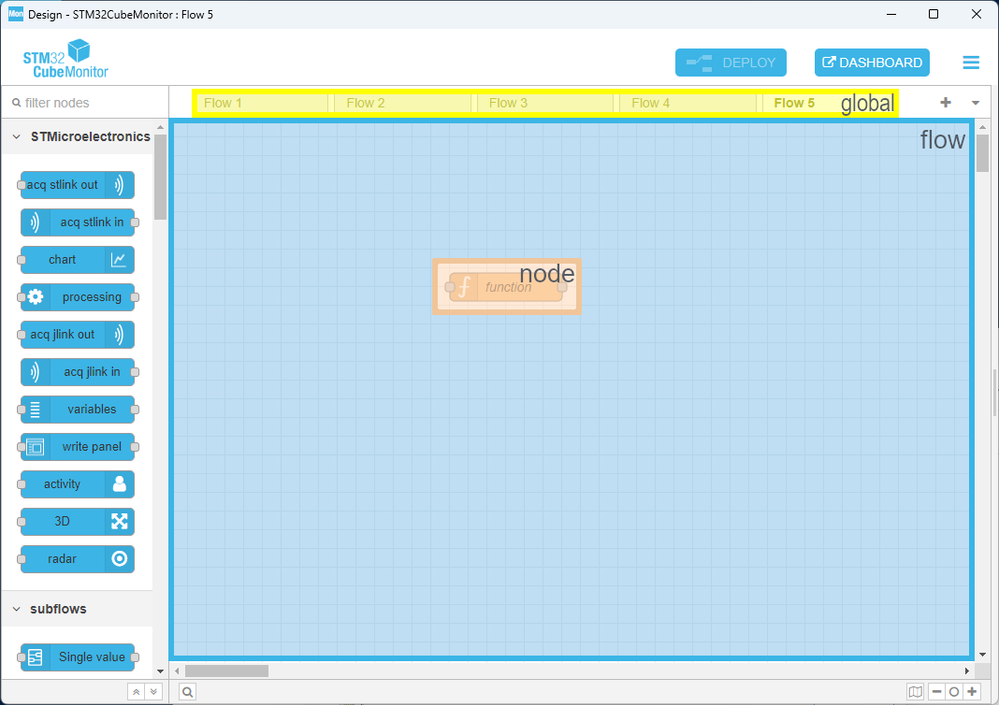

2.2 Context data storing
The main advantage of custom data processing in function node over the processing node is the ability to directly store and access data between messages. This allows you to implement processing of data, where such functionality is crucial - cumulative sum/integrals, more involved statistics methods etc.
Node-RED defines three scopes of context - node, flow and global. node context includes only the function node itself, while data stored in the flow context can be accessed across the flow, in which the function node is located. In STM32CubeMonitor each tab is a flow. With global context the stored data are available in each flow with its nodes. See the image below, demonstrating contexts and examples of storing and loading data in different contexts.
Fig. 4: Visualization of different scopesFig. 4: Visualization of different scopes

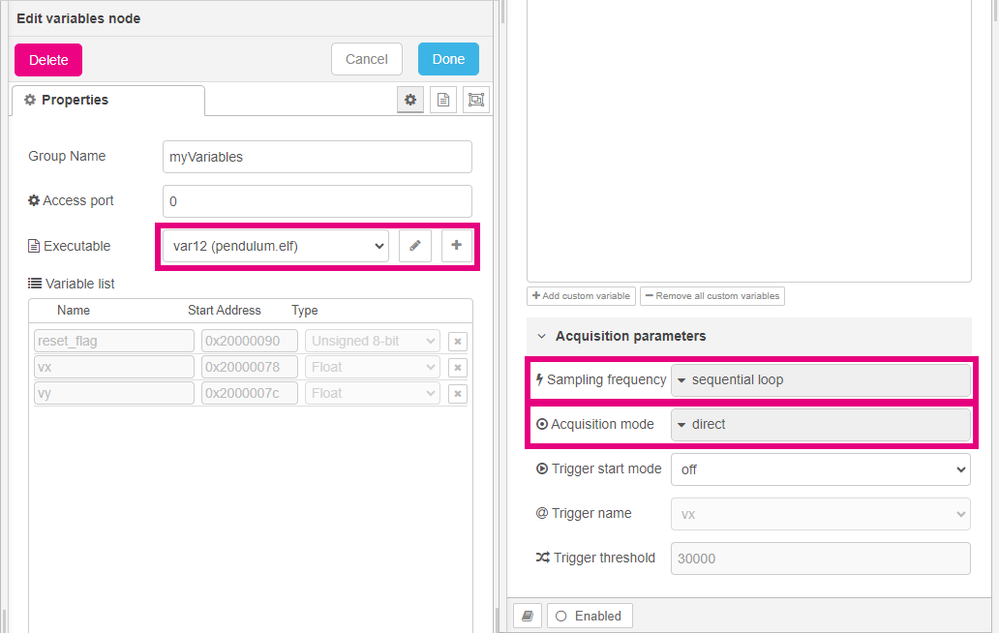

3.2 Setting up STM32CubeMonitor
Now let us set up the STM32CubeMonitor flow. We start from scratch, so that everything can be explained. Alternatively, you can use the basic flow as a starting point and just modify it. To view the basic flow example, right-click in a flow, go to "Insert" → "Import example flow", in the dialog window that opens, go to "Local" and select STM32CubeMonitor_BasicFlow.json.
First, we place the variables node, where we set up the executable to the .elf file for the code above and configure it to capture the variables reset_flag, vx, and vy. Configure the acquisition mode to direct and sampling frequency to a sequential loop. The alternative to direct mode is snapshot mode, which is not covered in this article and requires changes to the MCU code as well as to the flow.
Fig. 5: Variables node setupFig. 5: Variables node setup

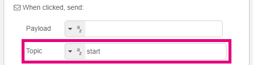

Then we create two button nodes. One sending a message with topic as a string "start" for starting the acquisition and one with topic as a string "stop" for stopping the acquisition.
Fig. 6: Button node topic setupFig. 6: Button node topic setup

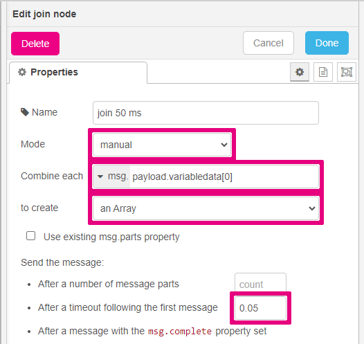

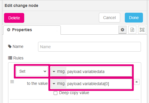

We want to emulate the processing node and decrease the computational load of sending each measurement in separate message to the chart node. To do that, we can route each of the first two outputs into a separate join node. Set each of these to manual mode. It should combine each msg.payload.variabledata[0] to create an Array. Set the "Send the message: After a timeout following the first message" to an interval in seconds I used 0.05 s so as to simulate the processing node behavior.
Fig. 8: Join node setupFig. 8: Join node setup
This process almost creates the msg structure that we want, although it encapsulates the variabledata array into an array. We need to extract it properly. We can use the change node with rule that sets msg.payload.variabledata to msg.payload.variabledata[0].
Fig. 9: Change node setupFig. 9: Change node setup

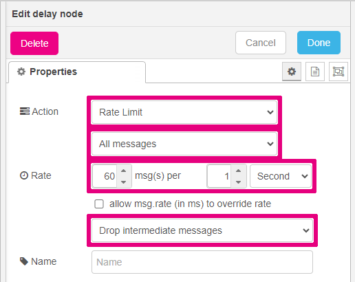

Now, just connect the third output of the emulating function node to the input of the centering function node. Connect its output to the radar node, while also setting its Group to the chart group. Additionally, you can put a delay node in between the emulating and centering function nodes to limit the dashboard message rate, to decrease the computational load even further.
Fig. 10: Delay node setupFig. 10: Delay node setup

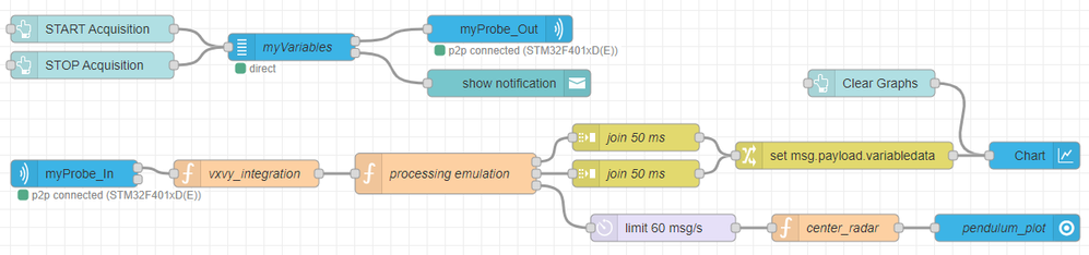

And we are done; you should be looking at a flow looking something like this:
Fig. 11: Final flowFig. 11: Final flow

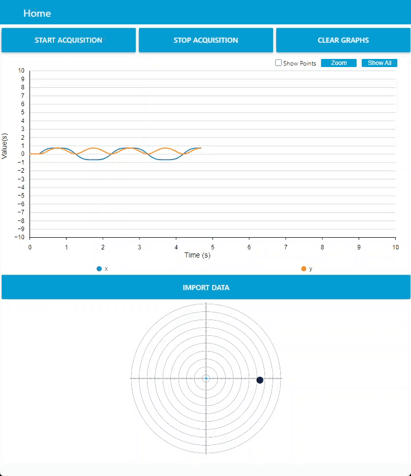

Finally, just deploy the flow, open the dashboard (upper right-hand corner), start the acquisition, press the physical button to zero and synchronize the integration, and enjoy the show.
Fig. 12: Example visualizationFig. 12: Example visualization
