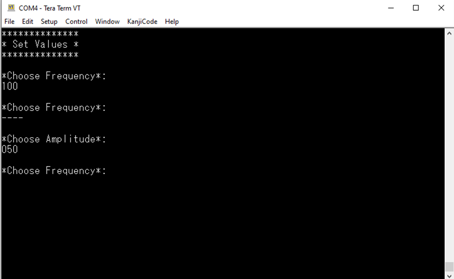

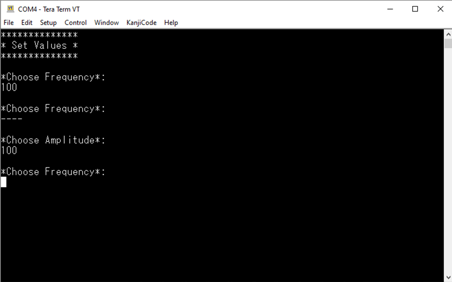

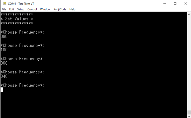

Results:
For this article implementation, we used Tera Term’s software to receive the input serial data, but any other terminal can be used:
The “Choose Frequency” string continues to repeat until the user’s button is pressed. Upon pressing, the “Choose Amplitude” string appears and this other parameter can be modified:
Now, it is possible to control the sine wave’s frequency and amplitude as you wish with minor limitations when it comes to the final frequency due to resolution.

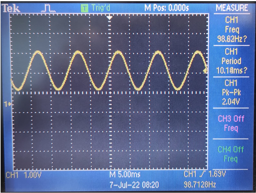

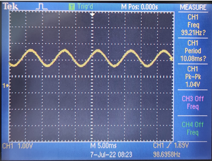

Below you can see a few value demonstration and the corresponding sine wave signal generated after the LPF:
