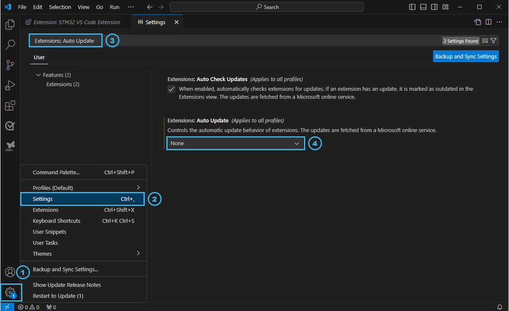

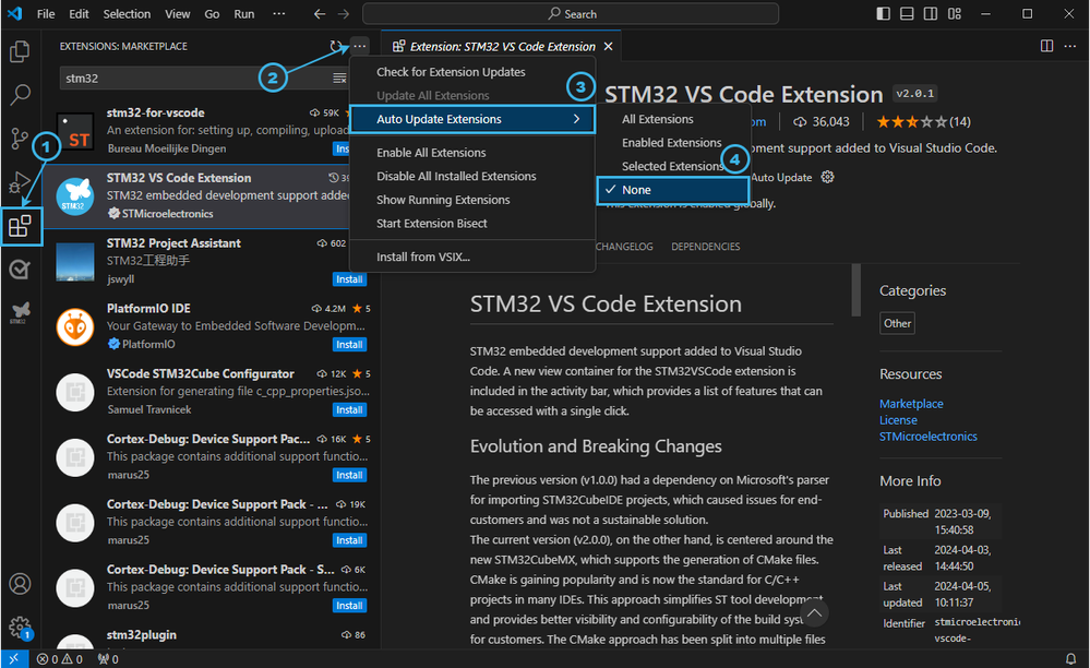

1. Disable extensions auto-updates in VS Code
To avoid extensions update, change the settings "Extensions: Auto Update" in either VS Code Settings editor (Ctrl+,) or directly from the Extensions tab.

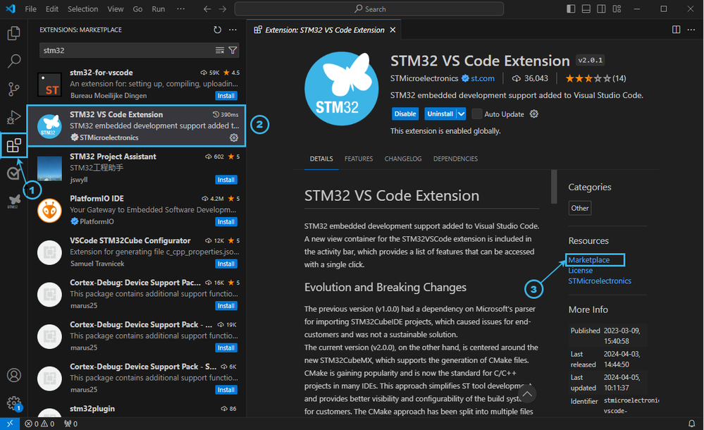

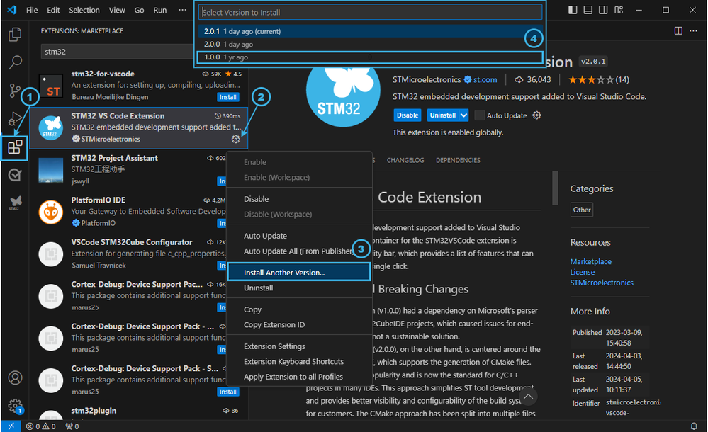

  • Go to the Extensions tab.
  • Pick the STM32 VS Code extension.
  • Click the gear icon and choose "Install Another Version." A list of versions to select from is then displayed.

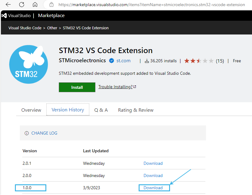

If the version you need isn't listed, get it from the Marketplace and install manually.
  • Go to the VS Code Marketplace from the extension.
  • Download the version that you need.

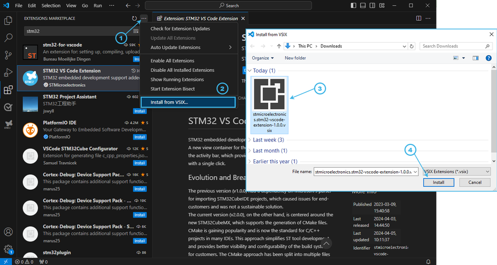

  • Go back to VS Code and click on "Install from VSIX..."
  • Find and choose the downloaded ".vsix" file, then click "Install" to finish.

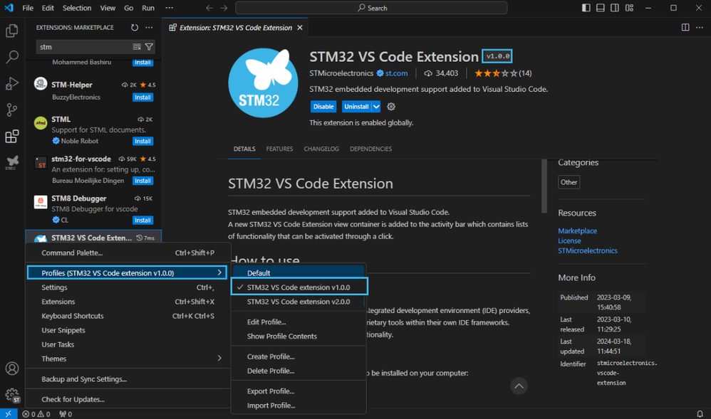

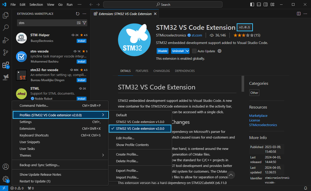

2.2 Keep multiple versions installed

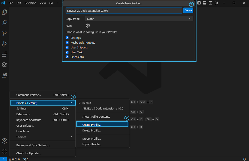

To retain a previous version of the STM32 VS Code extension while installing the latest version, you need to create a new profile by following the steps below:
  • Navigate to the VS Code profiles and create a new profile
  • Assign a name to the profile and complete the process by selecting "Create"
  • Proceed to install the latest version of the STM32 VS Code extension after creating the profile
  • Now, you have two profiles; one contains v1.0.0, and the other contains v2.0.0
