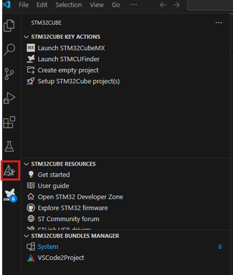

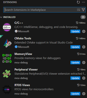

  1. In the VS Code application, open [Extensions] (Ctrl + Shift + X) and search for STM32CubeIDE for Visual Studio Code
  1. Install the [STM32 VS Code Extension]. It looks like this picture below.

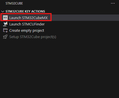

  1. Open STM32CubeMX from VS Code by selecting [Launch STM32CubeMX] located under "STM32Cube Key Actions".

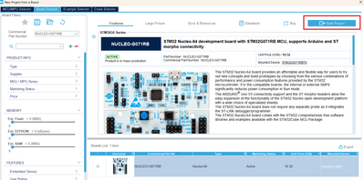

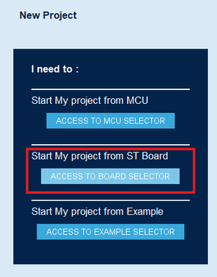

  2. From STM32CubeMX, start the project by selecting an MCU, a board, or an example. For the purposes of this article, start the project by selecting a board. Select [Access to Board Selector].
  1. Within the Board Selector, type NUCLEO-G071RB in the field "Commercial Part Number".
  1. Once the board is selected, select [Start Project].

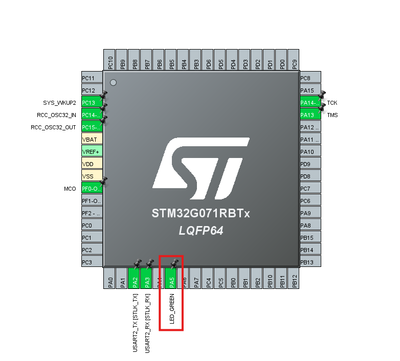

  1. In this article, we will be toggling the PA5 pin, which is connected to the on-board LED. This is already configured in STM32CubeMX, so no change is necessary. In general, the project can be configured at this point.

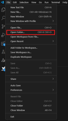

  1. In VS Code, select File > Open Folder, and navigate to the project folder you created in CubeMX.

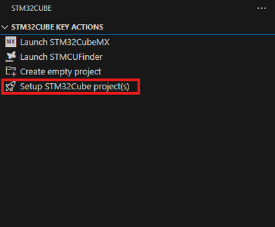

  2. At the bottom right of your screen a popup appears, asking if you would like to configure the discovered CMake Project as a STM32Cube Project. Select [Yes].
Alternatively, you can select [Setup STM32Cube project(s)] under STM32Cube Key Actions.

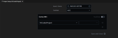

  1. The "Project Setup" tab opens, allowing you to configure your CMake project as a STM32Cube project. Under Board/Device, you can enter the part number that you are working with. For this example, you can enter NUCLEO-G071RB.
Once you select [Configure], the screen should look as below.

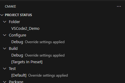

If you do not see the dropdown menu, you can set the "Configure Preset" from the CMake tab.
Once the project is configured as below, it is possible to change the code and build the project.

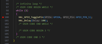

  1. In this article, we simply toggle the LED connected to PA5. To do this, add the following 2 lines of code to the while loop in main.c
HAL_GPIO_TogglePin(GPIOA, GPIO_PIN_5);
HAL_Delay(100);
Once these lines are added, the main.c file should look like this:

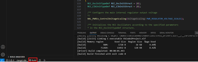

  1. Build the project by selecting the [Build] option in the bottom left of the screen.

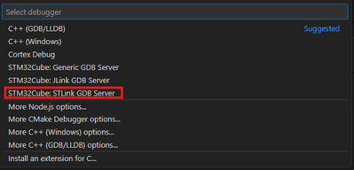

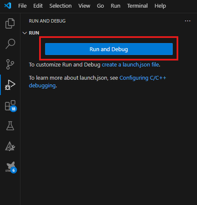

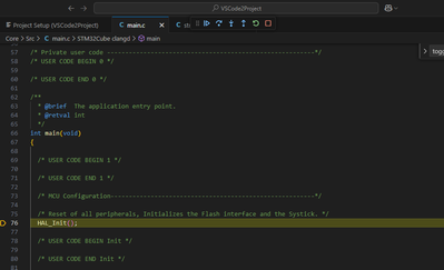

  1. Once the project is built, place any desired breakpoints and select [Run and Debug] in the Run and Debug tab on the left toolbar.
  1. A dropdown menu appears and here it is possible to select the debugger. For this example, we choose [STM32Cube: STLink GDB Server].
  1. After making that selection, the application will begin to run and pause at the initial breakpoint. Use the toolbar on the top to continue execution, pause execution, step into/over instructions, and terminate or restart the debug session.
