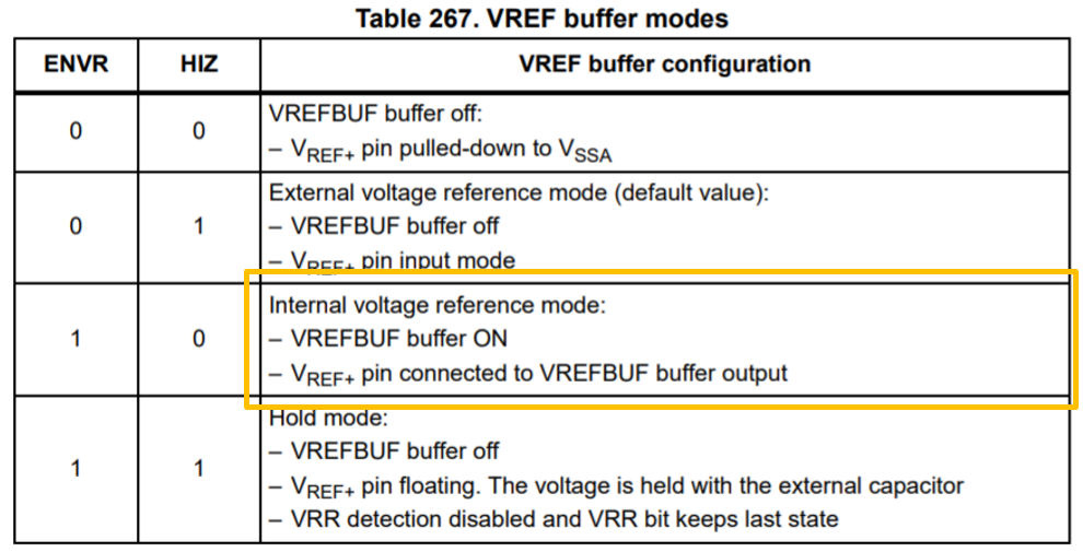

The internal voltage reference can be configured in four different modes as shown below in the table found in the STM32H723’s reference manual:

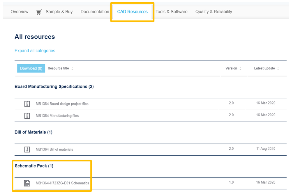

Each STM32’s respective board schematic can be found on the board’s landing page under the CAD resources tab.
In our case, checking the Nucleo-H723ZG’s schematic, there’s a 0-ohm resistor connection between VDDA and VREFP that must be removed.

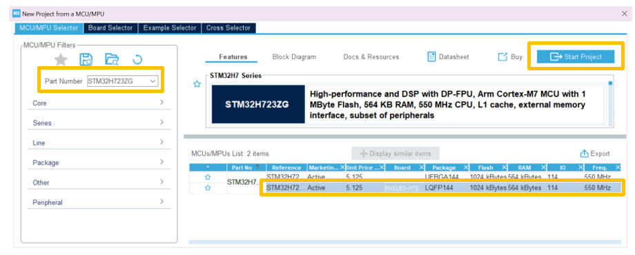

Step 2. Using STM32CubeMX start a new project with your selected STM32.

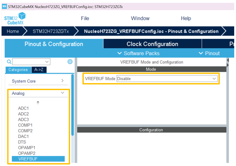

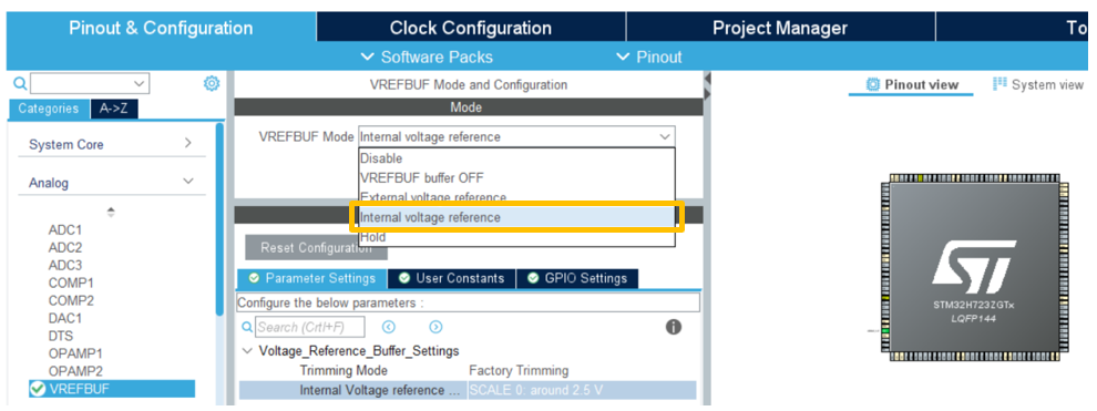

Step 3. The VREFBUF configuration is found under the ‘analog’ drop down category. By default, the VREFBUF mode is disabled.

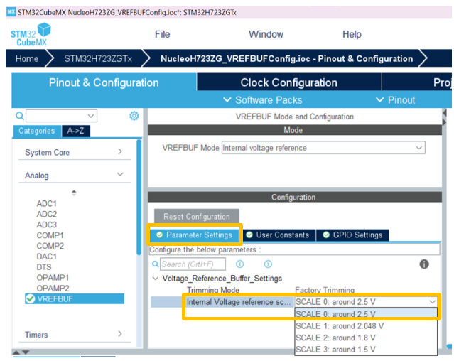

Step 4. From the dropdown menu, select the ‘internal voltage reference’ option.
Step 5. Under the ‘parameter settings’ tab below, select the scale that you want for the VREFBUF value. In our example case, we will select SCALE0: around 2.5V.

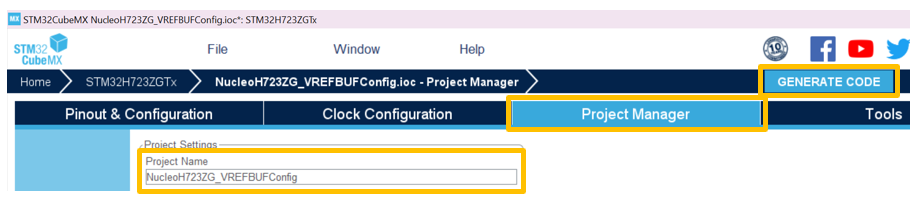

Step 6. Under the ‘project manager’ tab, give your project a name, save the project and generate the code in STM32CubeMX. Then flash the newly STM32CubeMX’s generated code to your STM32 board.

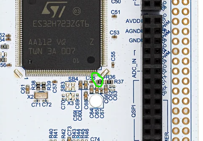

I'm a beginner, so i want to confirm things before i begin. I want to provide external reference for the 16-bit ADC. So from what you have said , i need to remove the  R36 (i'm using the same board), then i need to set the vrefbuf to external reference voltage, and the Vref+ pin on the board will be the input, to my external source will be connected.
I want to confirm, the one rounded by green circle is the R36.
With respect to the table, the max voltage i can supply to Vref+ is 3.6 so 3.3 should be fine, correct me if i'm wrong.
Also is there anything i should do for safety to avoid situation like this
