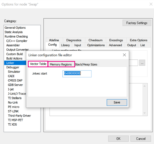

2. Check that vector table settings are as following (Project Options > Linker > Linker Configuration File Editor):
  • _intvec start: 0x08000000
  • ROM Start: 0x08000000 under Memory Regions
  • ROM End: 0x080FFFFF under Memory Regions

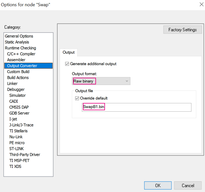

3. In output converter, select Raw binary and name the output file for bank1 as shown in the figure below
4.  Build the first part of the program dedicated to BANK1.

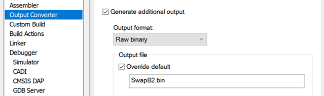

3. Go back to Output Converter and change the name of the binary file as follows.

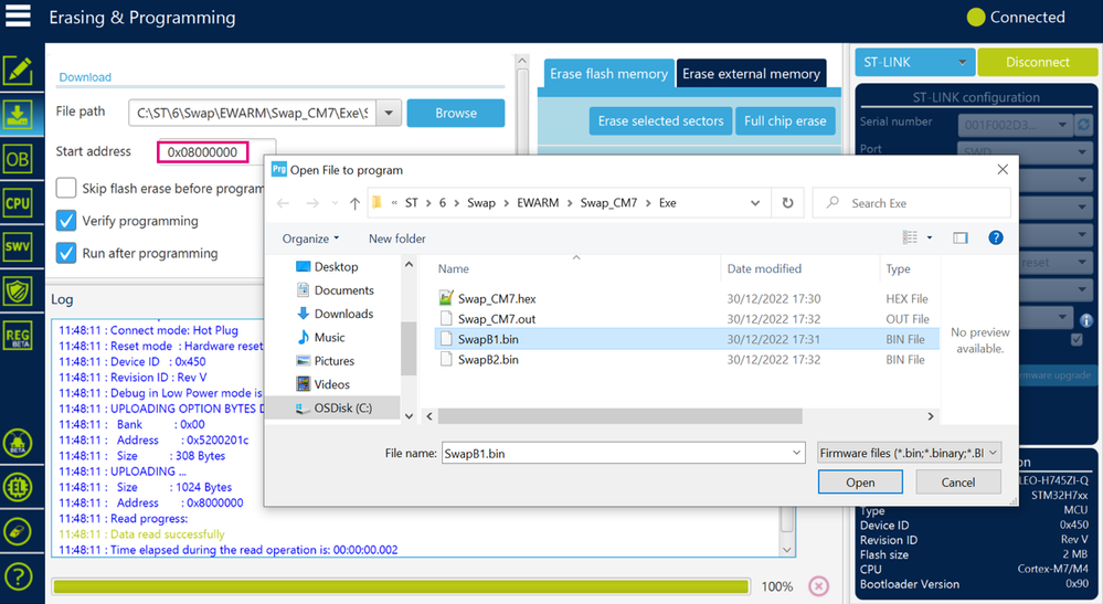

Use CubeProgrammer to connect and download the binary files.
  1. From Download>file path, select the path of your binary SWAP_Bank1.bin ( it should be under your workspace: xx\Swap\EWARM\Swap_CM7\Exe)
  2. Make sure that the start address is 0x0800 0000
  3. Click on download.

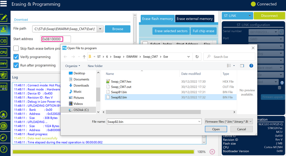

    4. The same way as previously described; you can download the second binary file at the start address of Bank2 (0x0810 0000).
At this level, you can disconnect from STM32CubeProgrammer. You can check that:
