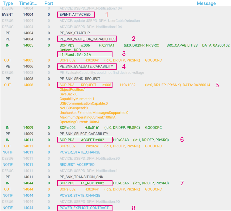

Expected behavior
When the sink application is configured correctly and a compatible USB PD source is connected, the trace should typically show the following sequence:
  1. The attachment is detected.
  2. The sink waits for source capabilities.
  3. The sink receives the source capabilities (IN message).
  4. The policy engine evaluates the advertised power profiles.
    • The PE processes the received capabilities in PE_SNK_EVALUATE_CAPABILITY.
    • A request Data Object is prepared according to the sink PDOs and the selected source PDO.
  5. The sink sends a request (OUT message).
  6. The source replies with ACCEPT, meaning the power transition has started but is not yet complete.
  7. The sink waits for PS_RDY, to confirm that the requested power is actually ready.
  8. The power contract is established.
