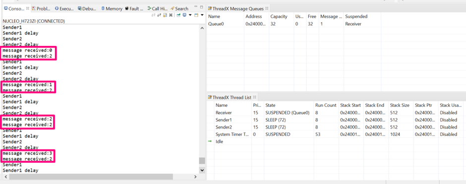

As you can see, the Sender2 will always send the message ‘2’ and the Sender1 will continue to increase its message value by one at every interaction.
Press Ctrl+B to build and enter in debug mode. By allowing the project to run, we’ll see that the order printed is:
Which is the exact flow as we anticipated:

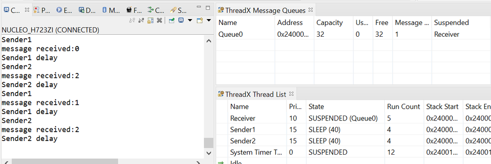

Now, as the final change, modify the priority and preemption priority of the Receiver thread to see how we can change things a bit.
Just to recall, this is how the priority and preemption threshold parameters works:
- priority: Numerical priority of thread. Legal values range from 0 through (TX_MAX_PRIORITES-1), where a value of 0 represents the highest priority.
- preempt_threshold: Highest priority level (0 through (TX_MAX_PRIORITIES-1)) of disabled preemption. Only priorities higher than this level are allowed to preempt this thread. This value must be less than or equal to the specified priority. A value equal to the thread priority disables preemption-threshold.
The Receiver thread should be updated to be like this:
tx_thread_create(&receiver_ptr,"Receiver",Receiver, 0, thread_receiver,THREAD_STACK_SIZE,10,10,1,TX_AUTO_START);
Now that the Receiver thread has a higher priority, we know it will be the first thread to be called when the application starts, plus it can preempt the Sender1 and Sender2 threads whenever the queue is available and it can only be preempted by a priority 10 thread, which is not present on the demo, thus we can expect this to happen:
And as we can see upon building and debugging, it is the expected flow:
