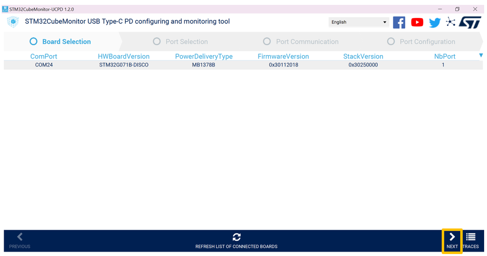

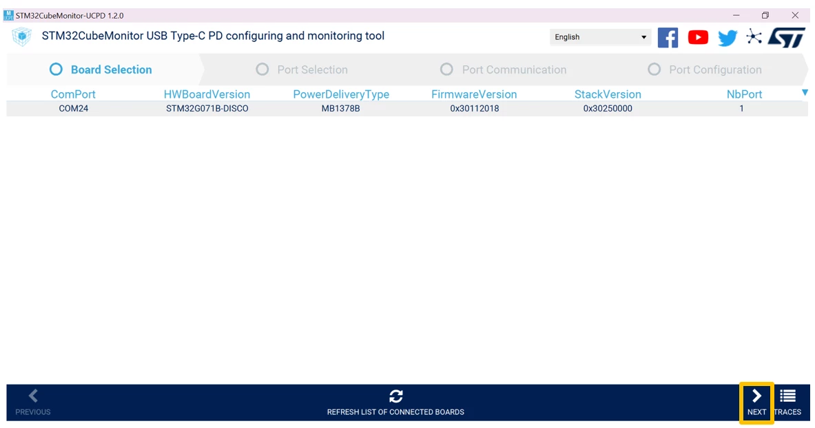

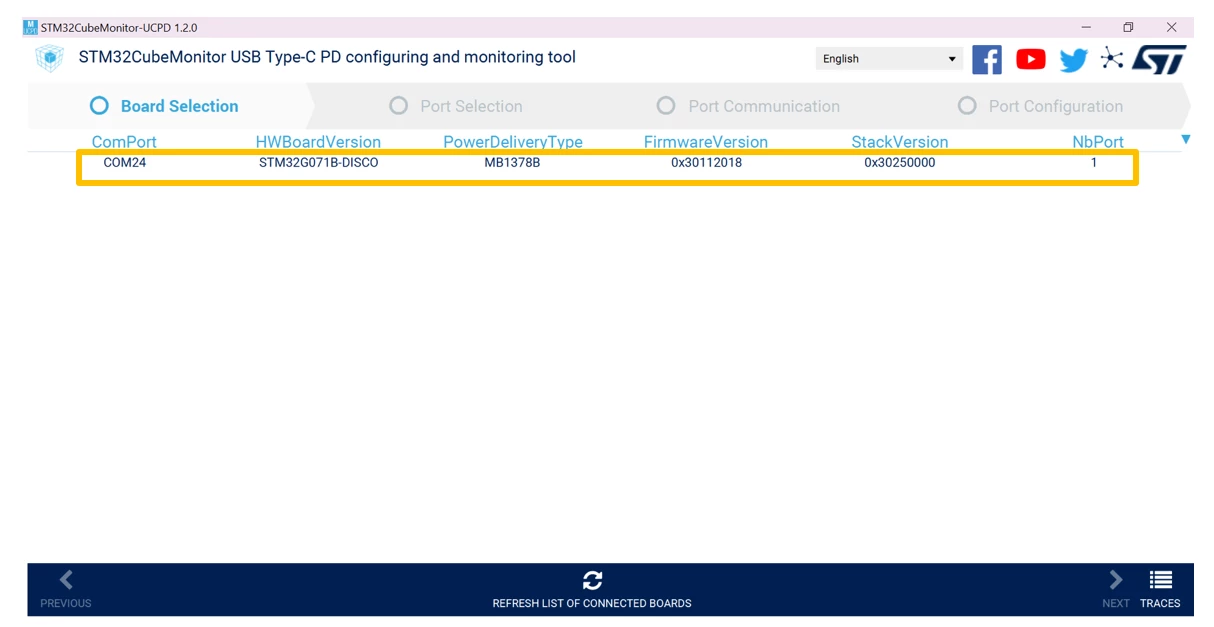

Step 2. Plug in your STM32G071-Disco board into your host machine and launch the STM32CubeMonitor-UCPD application. You should see your board’s information populated on the application’s home page; to get started you will need to select the board.

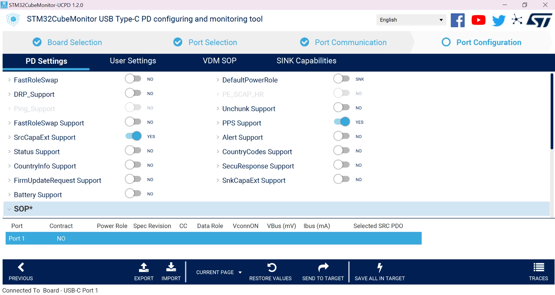

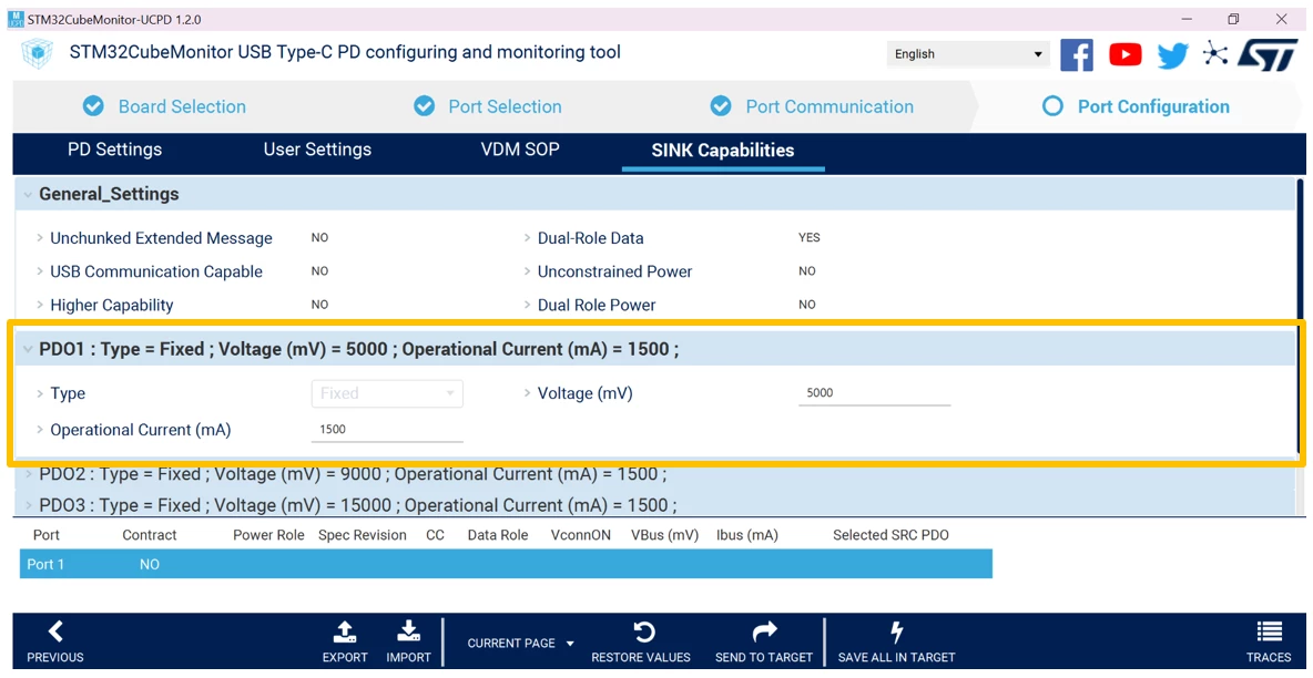

Step 3. On the bottom right-hand corner of the GUI, click on the “next” icon until you reach the “port configuration” page.

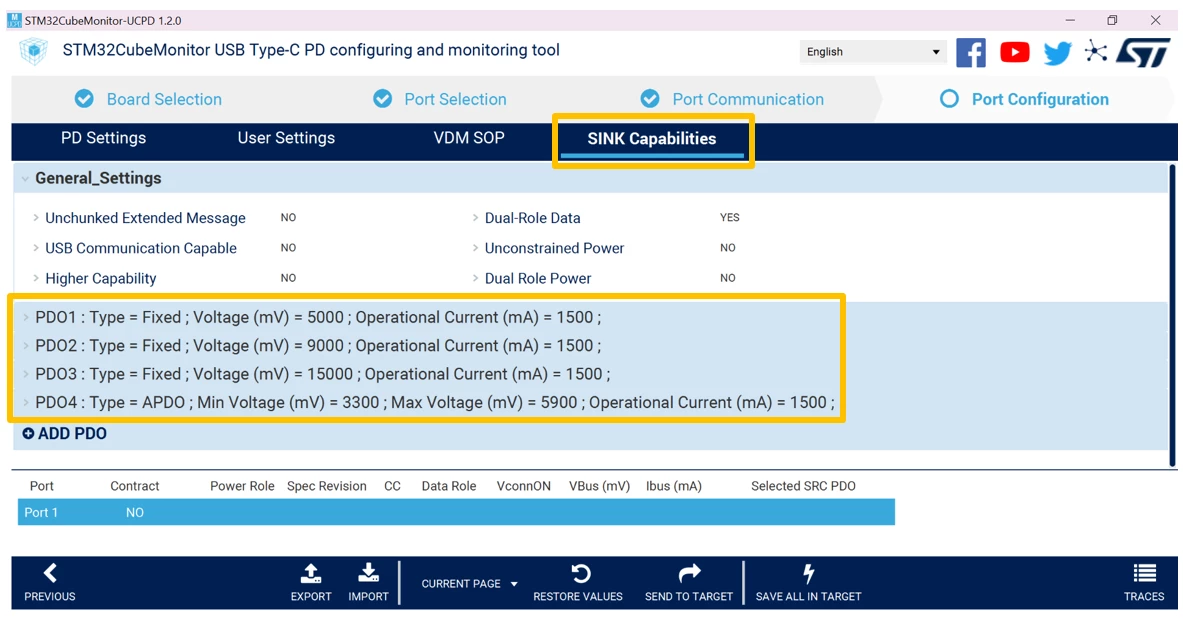

Step 4. Click on the “sink capabilities” tab, you should then see the board’s current PDO list pop-up on screen.
Step 5. To modify an existing PDO – select the existing PDO from the list, make your modifications, and then skip forward to step 7.

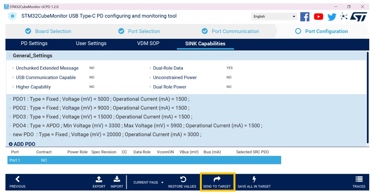

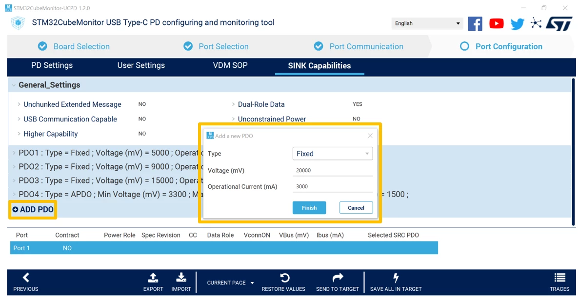

Step 6. To add a new PDO – click on the “add PDO” option and follow the pop-up prompt on the screen.

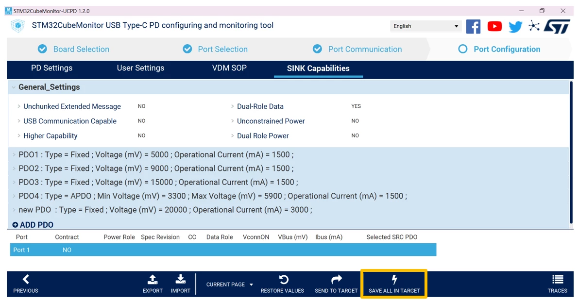

Step 7. Click on the “send to target” icon to send the updated PDO list to your board.
Step 8. Click on the “save all in target” icon to save the updated PDO list onto your board.
Congratulations! You have now successfully updated your STM32G071-Disco’s PDO list with the modifications or new additions.
