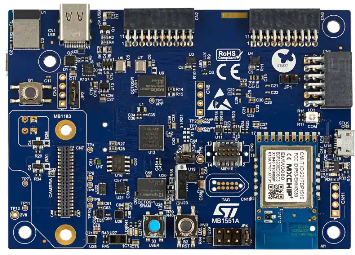

1. Hardware
The B-U585I-IOT02A discovery kit provides a complete demonstration and development platform for the STM32U585AI microcontroller, featuring an Arm® Cortex®-M33 core with Arm® TrustZone®, 2 Mbytes of flash memory and 786 Kbytes of SRAM. B-U585I-IOT02A board discovery kit enables a wide diversity of applications by exploiting low-power communication, multiway sensing, and direct connection to cloud servers.
It includes Wi-Fi® and Bluetooth® modules, as well as microphones, temperature and humidity, magnetometer, accelerometer and gyroscope, pressure, Time-of-Flight, and gesture-detection sensors.
 B-U585I-IOT02A
