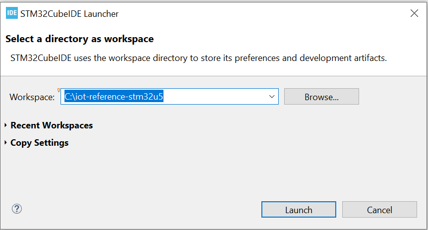

The b_u585i_iot02a_ntz project does not use the TrustZone® capabilities of the U5 board. With the project cloned on the C drive, open STM32CubeIDE. When prompted with setting workspace, click on Browse and navigate to C:\iot-reference-stm32u5 as shown below:
Note: If the prompt does not come up, look at the Troubleshooting section of this document at the end.

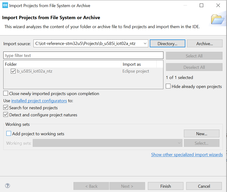

Under Project Explorer, click on Import projects.
In the pop–up tab, click on Existing projects into workspace:
Hit Next. The following prompt pops up:
Click on Browse above and navigate to the root of the project. Click on Finish.

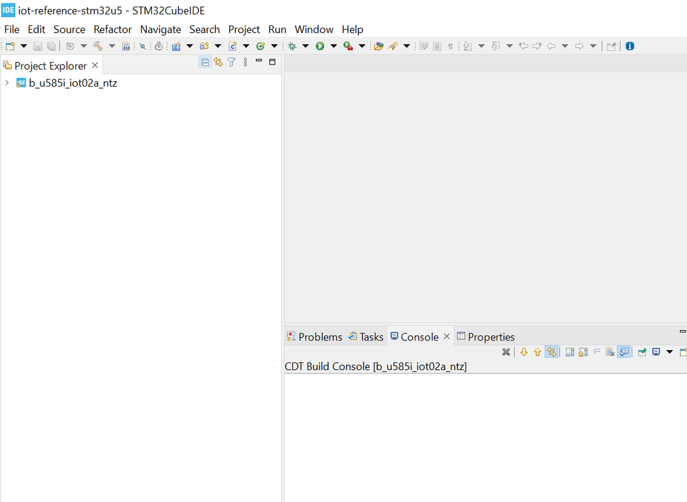

This is how the workspace with the imported project looks like:
Build the b_u585i_iot02a_ntz project.
Flash the binary by clicking on Run->Run. Make sure that the board is plugged in to flash the project to the board.

  1. Upon opening STM32CubeIDE, if the prompt to set the directory does not come up, Click on File->Switch Workspace->Other, and set the workspace as shown below:
