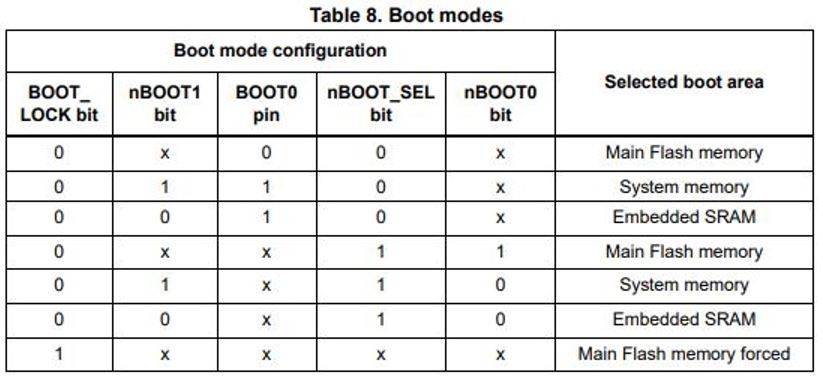

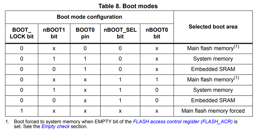

1.1 How to select the boot target
The answer is available in the reference manual of your STM32 in the chapter "Boot configuration".
Below is an example of a boot configuration definition for a STM32G071:
See section 2.5 page 68 of RM0444 Reference Manual STM32G0x1.​​​
According to the STM32 selected, this configuration depends on a combination of
Pin values:
  • BOOT0 and BOOT1 pins level, if available on your package
  • Option bytes:
  • nBoot0/nBoot1/nBoot0_SW
  • BOOT_ADD0/BOOT_ADD1/nBOOT0_SEL
  • nDBANK/BFB2
  • BOOT_LOCK
  • TZen/NSBOOTADD0/NSBOOTADD1
  • RSSCMD/SECBOOTADD0/SECBOOTADD1
  • RDP
  • Content of the user flash
Warning: in RDP level 2, the device can only boot from main flash memory.
