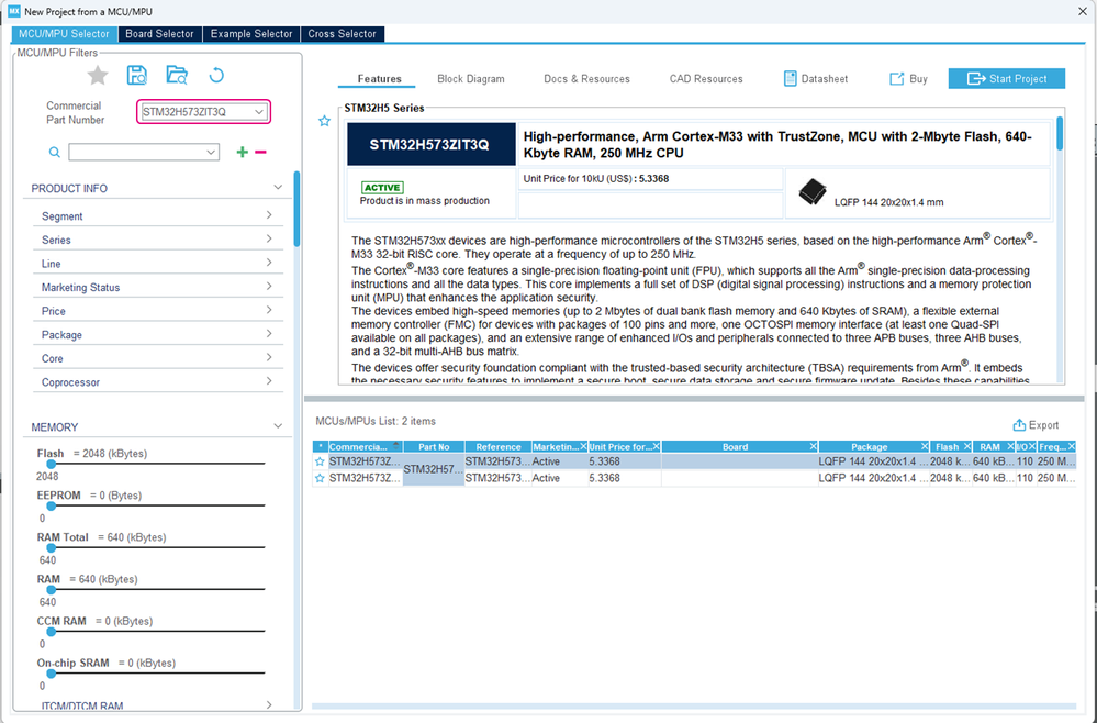

1.1 Step 1: Create a new project with STM32H573ZIT3Q
  • Open STM32CubeMX.
  • Click [New Project].
  • In the MCU selector, enter [STM32H573ZIT3Q] and select it.

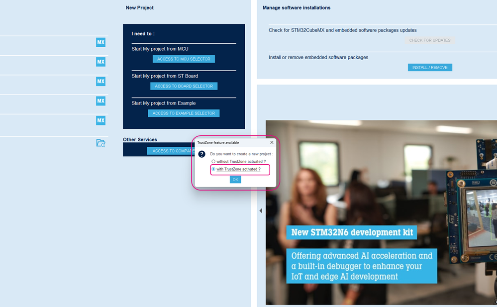

1.2 Step 2: Enable TrustZone®
  • In the "Project Manager" tab, enable TrustZone®.
  • Configure the TrustZone® memory partitions (secure and nonsecure) according to your application needs. This step ensures that the MCU operates with TrustZone® security enabled.

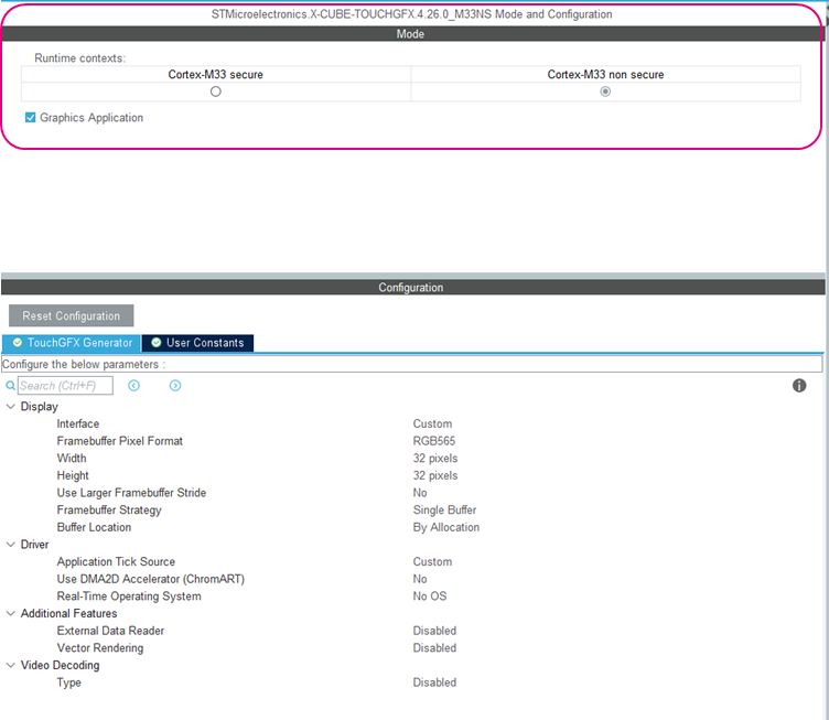

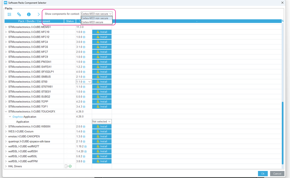

1.3 Step 3: Enable the X-CUBE-TOUCHGFX software pack
  • Navigate to the "Software Packs or Middleware" section.
  • Locate X-CUBE-TOUCHGFX.
  • Enable the TouchGFX package specifically in the Cortex®-M33 nonsecure context.
Note: The software pack must be enabled in the nonsecure domain to ensure the GUI runs outside the nonsecure context.
