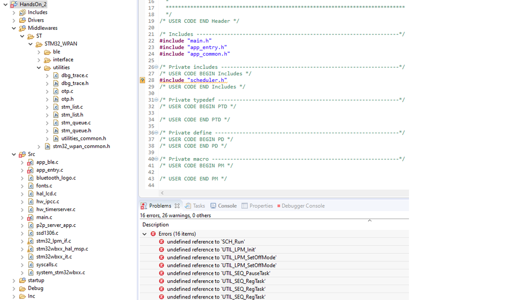

I am trying to do the example "HandsOn_2" from STM32WB_workshop. Executes commands as described. The only difference is I use STM32Cube_FW_WB_V1.3.0 instead of STM32Cube_FW_WB_V1.0.0.
STM32Cubex does not copy the scheduler.c, scheduler.h files to the directory ...\Middlewares\ST\STM32_WPAN\utilities\ . Why in STM32Cube_FW_WB_V1.3.0 files scheduler.c, scheduler.h don't exist?

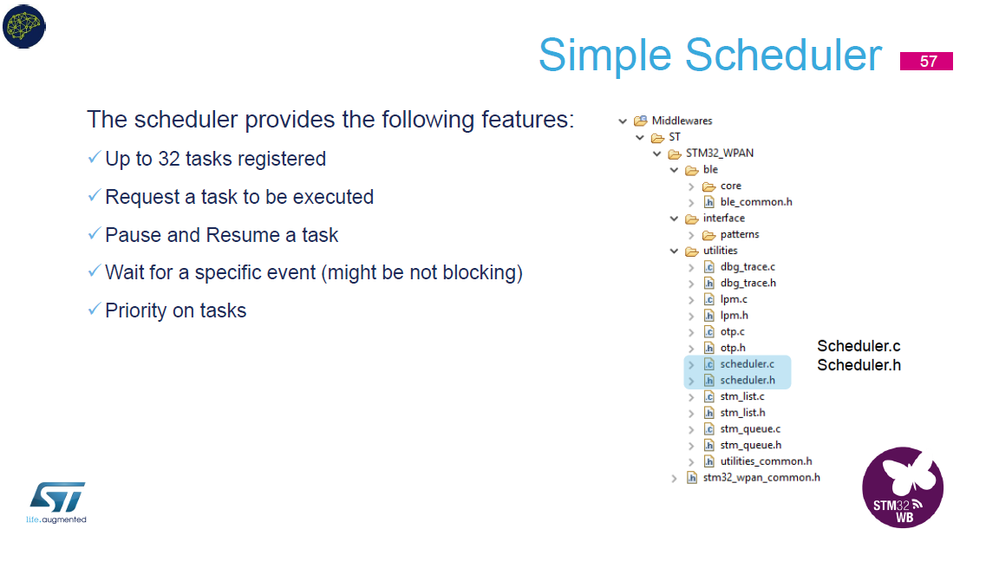

Do ST employees read this forum?

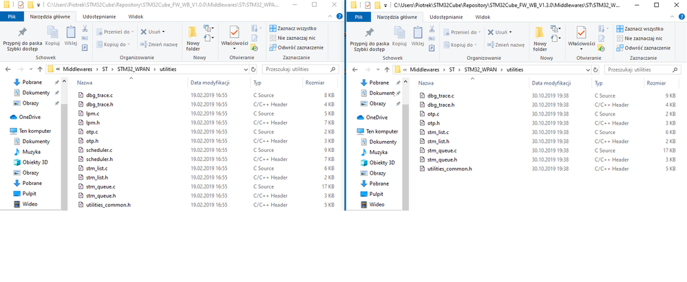

Why in the firmware package STM32Cube_FW_WB_V1.0.0 in the directory ... \ Middlewares \ ST \ STM32_WPAN \ utilities \.
There are files: scheduler.h, scheduler.c, lpm.h, lpm.c.
Whilst in the latest STM32Cube_FW_WB_V1.3.0 firmware has been removed?
In the 03-STM32WB-WS__How_to_add_BLE_funkcjonalność_V2.2.pdf file on page 57, ST refers to files that do not exist in the latest version V1.3.0.
Please reply.

Thanks for the answer,
In firmware package STM32Cube_FW_WB_V1.3.0 files scheduler.c, scheduler.h don't exist?
What path to show?
