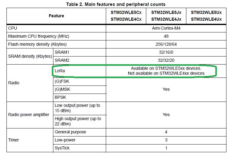

What is difference between STM32WLE5CC and STM32WLE4CC? It looks like they are both M4, single core, same stats etc.
John Davis
No LoRa on LE4, less cost/licensing..
4 REPLIES 4
Uwe Bonnes
Principal III
thank you. Do you have a link for this table?
https://www.st.com/resource/en/datasheet/stm32wle5c8.pdf
