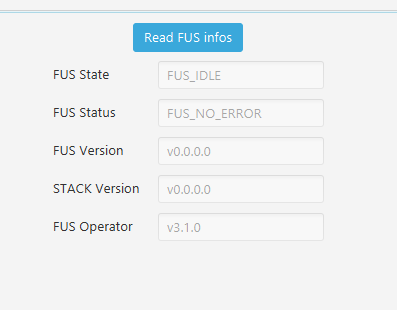

I am using the STM32WB55RG MCU, Bluetooth feature with stack version 1.13.0 and FUS version 1.2.0. Everything was working normal until I tried doing the firmware upgrade of stack from v12.0 to v13.0. I am not able to perform FUS related operations. The version reading shows 0.0.0 for FUS. And following is the log when I hit "Start FUS"

 11:09:51 : Error: FUS_STATE_ERR_UNKNOWN
 11:09:51 : Start FUS failed !
 11:09:51 : Error: Start FUS Operation Failure! Please, try again

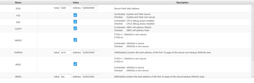

Following is OB info attached. Cube programmer version I am using is : v2.9.0
What could be the issue, please let me know how to resolve FUS and start wireless stack successfully ?

Sorry about that, here it is:0693W00000KbzEcQAJ.png

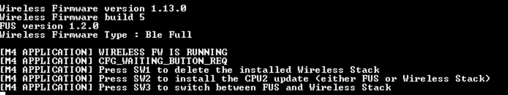

You can flash the binary via STM32CubeProgrammer in "Erasing and Programming" window at 0x08000000. When it's done, if you are able to connect your board to a HyperTerminal (TeraTerm for example), you have some logs which displayed FUS and Wireless Stack version like this:
0693W00000Kc8oQQAR.pngYou can also see if the FUS is runnning or if WS is running.
Others solution with STM32CubeProgrammer, try to delete Wireless Stack with "Firmware Delete" button.

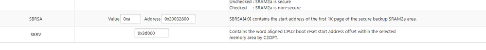

Remi QUINTIN
Just missing the ESE and SBRV value.
For the old board, you may need to update the FUS version.
Can you try to read the FUS version via the USB port in DFU mode at address 0x0x20030030?

Remy ISSALYS
According to your screenshot, SBRV is equal to 0x3D800 that indicate FUS v0.5.3 is running on your board. So, you must update the FUS using the stm32wb5x_FUS_fw_for_fus_0_5_3.bin binary.

Remi QUINTIN
oups I did not see the small window below :) for the SBRV value.
