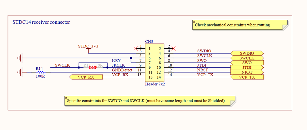

I am using STM32WBA5MMG in my design. This the development board schematic. Below image is from development board schematic.
As per the constrains , SWDIO and SWCLK must be length matched. Also need to provide a shield.My questions are given below.
  1. SWDIO and SWCLK are not differential lines, why length matching is required for them.
  2. By shield did they mean routing SWDIO and SWCLK on top of a solid GND plane

I found a description of these in the STLINK-V3SET User Manual:
https://www.st.com/resource/en/user_manual/um2448-stlinkv3set-debuggerprogrammer-for-stm8-and-stm32-stmicroelectronics.pdf#page=24

These are not usual requirements for SWD !
HariomAuthor
January 19, 2026
May I know what you mean by GNDDetect and KEY JRCLK signal?
