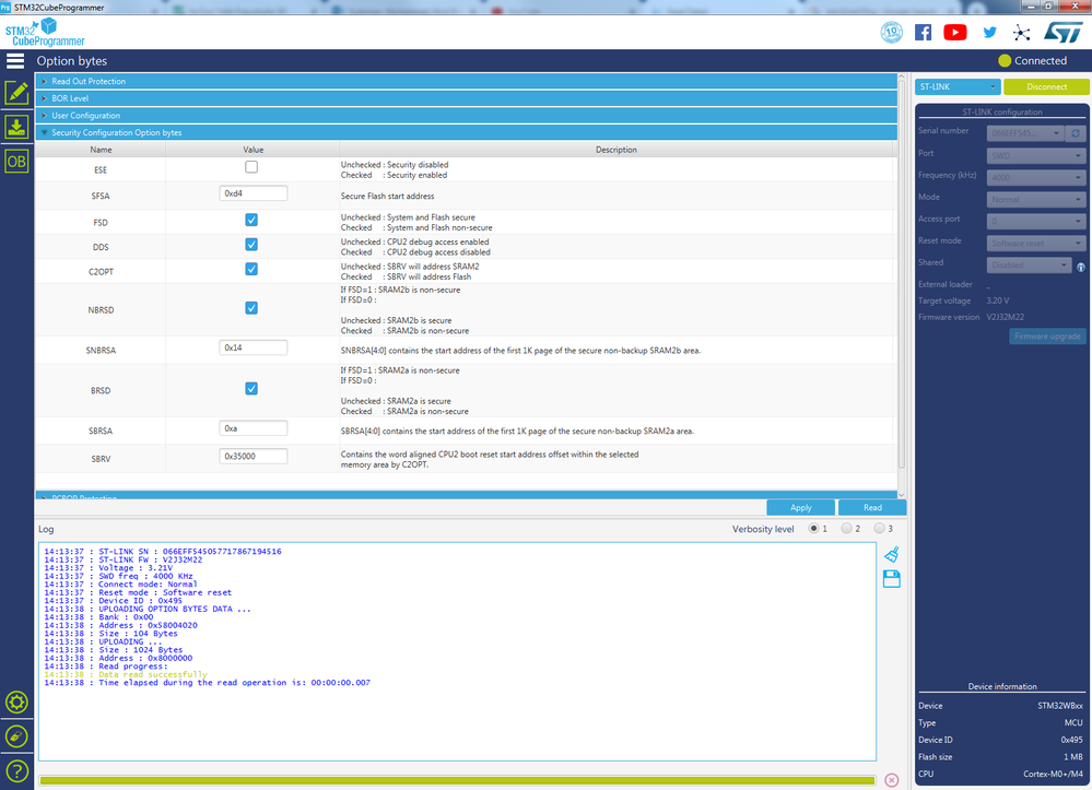

Would it be possible to check the option byte of the faulty device ?
In fact, I am interested only by the SBRV option byte.
Regards.

Here is the option byte page from CubeProgrammer. I didnt change anything from default (i guess).

Christophe Arnal
You are correct, the CM0+ should be considered as a blackbox. I wanted to make sure the option bytes was still correct as you tried to make some CM0+ update.
According to what I can read, the option bytes are correct and the BLE Stack running on CM0+ should be working fine.
The last option byte that may break something is IPCCDBA (user option byte) that should be set to 0 (as long as you are using the delivered BLE application).
As long as the board was working fine with official BLE application and does not work anymore with the same official application, I believe something is wrong with the board or the board settings..
Regards.
IPCCDBA is set to 0. For your information, the new board have SBRV set to 0x30000. Tried change it on the faulty board, denied.

Christophe Arnal
​Hello,
To complete the information regarding option bytes, there is no way for the user to change any secure option bytes. These are fully controlled by the CM0+ on each update. The SBRV is aligned with the content of the CM0+.
On each CM0+ update, if the new wireless image is getting bigger, the SBRV will be updated accordingly along with the SFSA that reflects the secure flash boundary to secure more flash memory ( giving less memory to the application).
