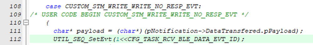

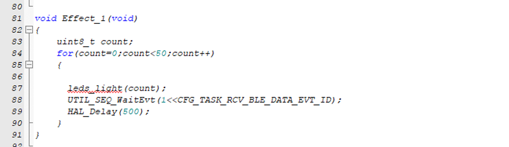

Kolab
Senior
here is the loop
and here the recepetion of the data
Remi QUINTIN
​It looks good!
You can play with the priority of the task using the UTIL_SEQ_SetTask( UTIL_SEQ_bm_t TaskId_bm , uint32_t Task_Prio ) function.
But in the end, the sequencer is a loop. So all tasks should be executed.
In our examples, all our tasks have the same priority.

the low power mode didn't stop the reception of the event concretelly, but has stopped the loop, that is, when the program enters in the loop it gets stuck in the wait function while there is no event . And at this moment the loop doesn't go forward as it should go. I would like so as to while the system waits for the event the loop runnned.
Remi QUINTIN
​Please find a basic presentation of the sequenceur. the last 2 pages could be a way to do what you want.
You have to overload the UTIL_SEQ_EvtIdle() function (have a look at the BLE examples)
void UTIL_SEQ_EvtIdle( UTIL_SEQ_bm_t task_id_bm, UTIL_SEQ_bm_t evt_waited_bm )
  UTIL_SEQ_Run( UTIL_SEQ_DEFAULT );
 This enables all tasks to run (even re-entering in the current task)
The implementation by default is
__WEAK void UTIL_SEQ_EvtIdle( UTIL_SEQ_bm_t TaskId_bm, UTIL_SEQ_bm_t EvtWaited_bm )
 UTIL_SEQ_Run(~TaskId_bm);
 return;
This allows all tasks to run except the current one.
