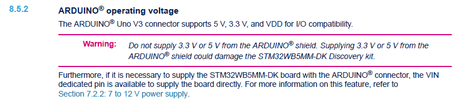

This might be a dumb question but can the STM32WB5MM-DK power a 3.3V peripheral device?
This part of the user manual makes it sound like the whole Arduino shield should not be used to supply any sort of power:
Yet according to this table, pin 4 should be able to do what I need
Solved! Go to Solution.

Hello @Hichamm
"Do not supply 3.3 V or 5 V from the ARDUINO® shield. Supplying 3.3 V or 5 V from the
ARDUINO® shield could damage the STM32WB5MM-DK Discovery kit" means that you should not supply the STM32WB5MM-DK board with the ARDUINO connector. But you can use the 3V3 pin or the 5V to supply your sensors for example.

‎2024-09-04 8:44 AM
Thanks, the wording made it quite misleading but it makes sense now.
