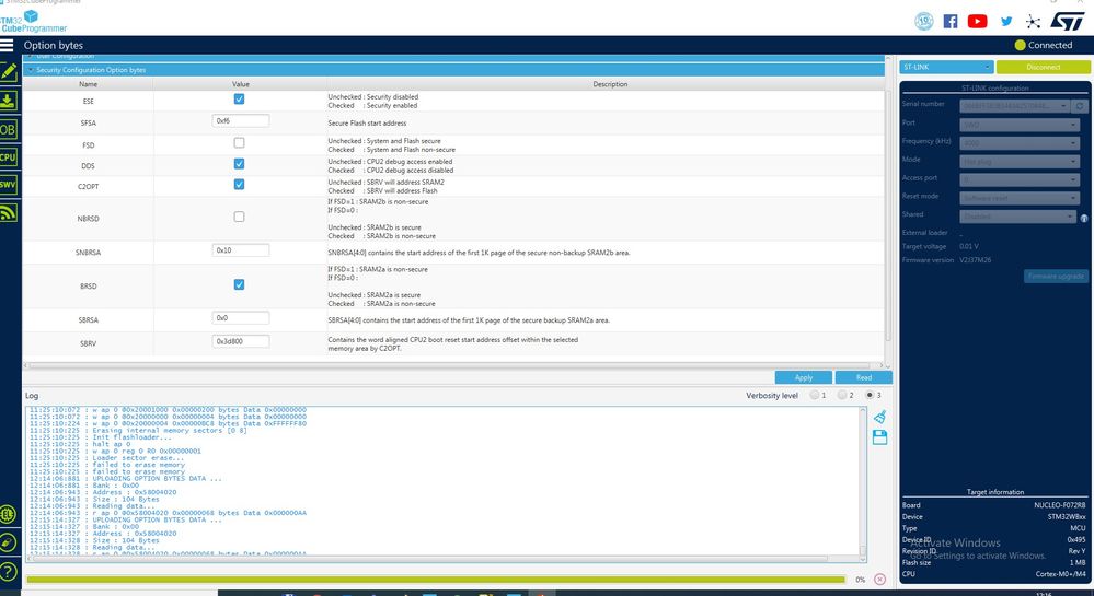

​For the option bytes, send a screen shot of the CubeProgrammer tool once in the OB section.
> have only SWDIO / SWDclk and GND connected from a nucleo board. => I your board a Nucleo board or yur own custom board? I dont understand this sentence.
Mass erase fails because it encounters the memory blocks protected by the SFSA limit. But all blocks under SFSA location should be correclty erased.
HSpre.1
Hi I am using my own board. I have produced 18 boards.
I am connected to this board using a nucleo as programmer (nucleo-f072RB). I am only connecting SWDIO / SWDclk and GND from the nucleo board to my stm32wb55 board. the STM32WB55 board is powered with a battery.
see below scren grab , not certain which part you want to see of option bytes?

Remi QUINTIN
Few remarks
SFSA = 0xF6 means that the FUS version is still v0.5.3. So you should try to upgrade the FUS version to V1.0.2 and then to v1.1.0.
Regarding the frequency, a lower programming speed could increase the reliability of the write accesses. But I must admit that the 4000Khz frequency I am using to program the WB Nucleo board is working well with the USB interface; with the SWD too though with more error. I don’t know if there is a link with the programming frequency.
