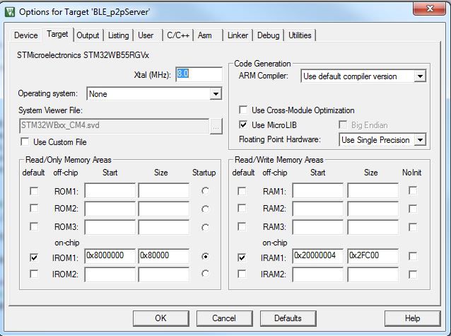

What Compiler do you use? I use MDK5 and I had to modify the Memory Areas in the generated Project files:
Then check if the Switch HAL_IPCC_MODULE_ENABLED is enbaled in stm32wbxx_hal_conf.h.
Then check the RTC and clock initialization. I took These over from the example Project.
Regards!
Holger

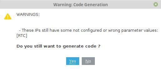

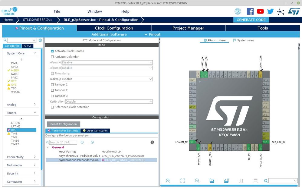

I have cloned STMicroelectronics/STM32CubeWB repository [Release v1.2.0], then updated STM32CubeMX and at the end opened BLE_p2pServer.ioc file in STM32CubeMX. There is a problem with "CFG_RTC_SYNCH_PRESCALER".
So I can not generate a project.
How to solve this problem?
