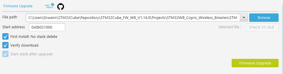

I'm currently facing a problem with my STM32WB15CC application and I could really use some guidance from the community. I am working on a BLE advertising application, but unfortunately, I am unable to see my device appearing as expected. After some investigation, I suspect that the issue might be related to the stack.
To resolve the problem, I attempted to upgrade the stack. However, it seems that upgrading it resulted in the deletion of my code. On the other hand, flashing the code onto the microcontroller appears to delete the stack. Interestingly, when I tested the same code on the STM32WB35CC with the same firmware version, it worked perfectly fine.

I done some progress these last days.
I can load the full task into the chip without errors (V16 for STM32WB1xx):

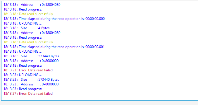

I can't read the full memory of the WB15CC. With STProgrammer when I click on "read all" button, I get this message :

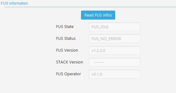

When I run the FUS and try to learn the version used by my component, the BLE version is always equal to "---". When I do the same operation with the WB35CC is working well and I can see the correct stack version in this location.
My feeling is the stack binary is not the good one (I already checked my version) or the WB15CC is not properly known by STProgrammer and the memory adress are not the good one.
@Remy ISSALYS​ Is it a kown issue ? Why I cannot read my full flash memory ?

Remy ISSALYS
You can read only the non-secure part of the flash memory, the "read all" button read more data than the non-secure part that's why you have the error. Use "read" button with 0x21000 for size to read all the non-secure part. Concerning the stack version, it's a known issue in STM32CubeProgrammer tool, I hope it will be corrected soon.

Remy ISSALYS
No, the issue concerns only the display of Stack version in STM32CubeProgrammer tool. You can try an example available in STM32CubeWB package like BLE_HeartRate to see if you have the same behavior or not,
