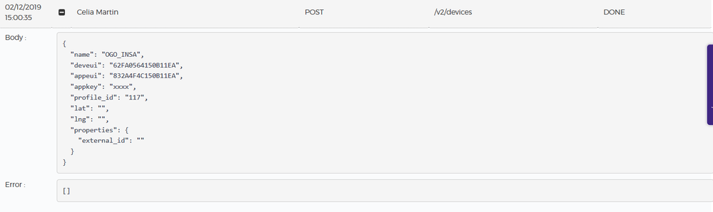

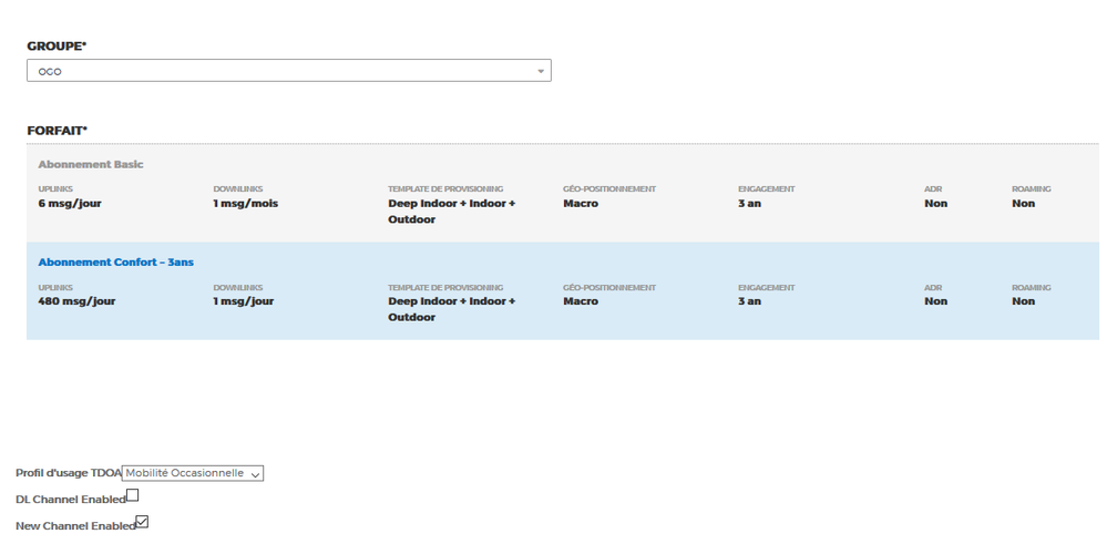

Here are the parameters that i've set/chosen on the server :

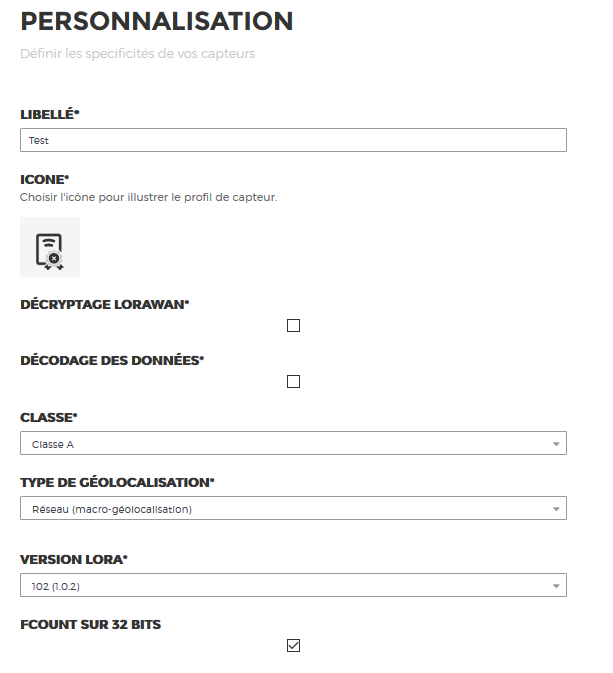

here is the device parameter according server point of view :

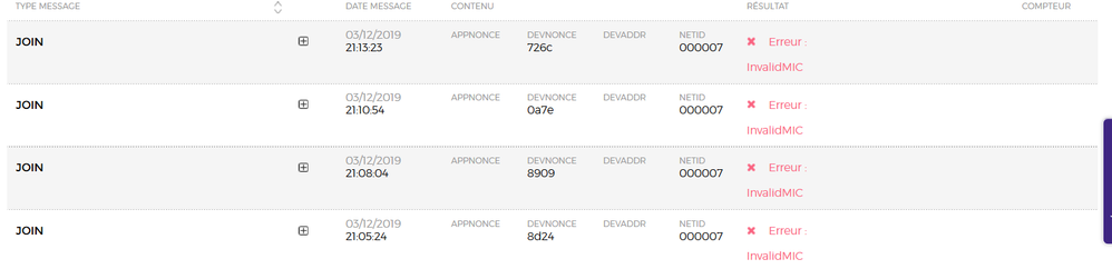

and finally the error :

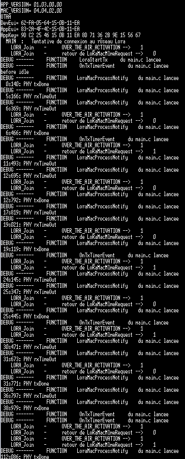

Here you can also check the debug frames printed when i launch the program in debug mode :
1 means that LoRaMacMibSetRequestConfirm function returns "LORAMAC_STATUS_BUSY"
0 means that LoRaMacMibSetRequestConfirm function returns "LORAMAC_STATUS_OK"

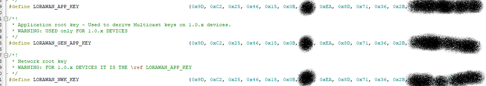

I don't know why i can't send data to the server whereas all key are the same on both sides.
Maybe should i check the the appkey again... any help ?

I found the answer. In this picture, the third constant (LORAWAN_NWK_KEY) was not equal to the others :
