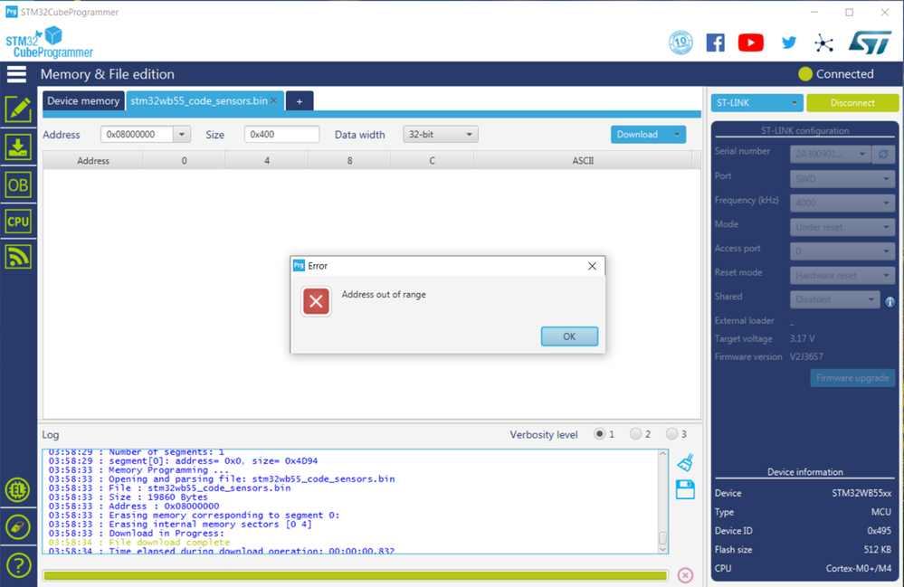

Just two things in last resort
1) Use hw reset as the default reset mode in the GUI of CubeProgrammer
2) There are many some digits hidden in the window dedicated to the load address that generate an “out of range�? value? I got some issue with that in the past.
Kolab
Senior
when i click on "ok" it downloads the binary. When I reconnect, in Device memory he appears in the wanted address 0x08000000
Remi QUINTIN
>>I have two boards . The same app in the other board works properly.
So it is a board issue. I will try to get more explaination on the "reserved" error.
I really dont udertsand why you get this "address out of range" error.

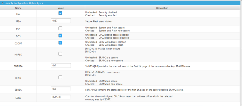

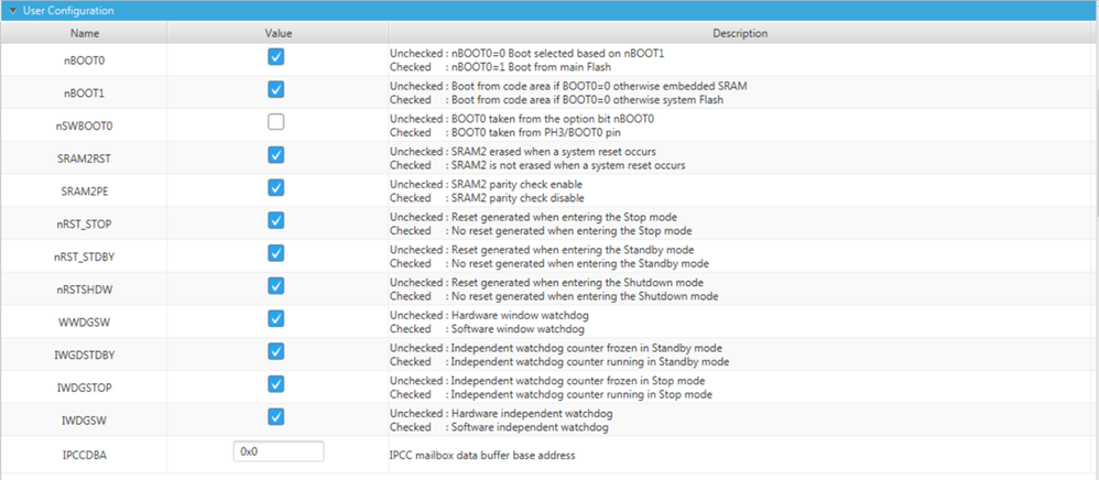

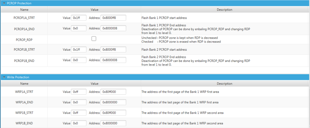

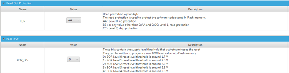

could you get a look at my options bytes? to check if it is allright there
Remi QUINTIN
Yes. So could you download them here so that I can check them?
Kolab
Senior
0693W000001r8yOQAQ.png0693W000001r8yJQAQ.png0693W000001r8yEQAQ.png0693W000001r8y9QAA.png
