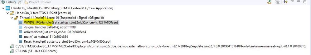

I comiled the BLE_HeartRateFreeRTOS project example located at STM32Cube_FW_WB_V1.3.0 (CubeMX 5.4) as CubeIDE (1.1.0) project,
However the project start running then stucked inside the procedure osKernelStart();
seems, received an WWDG interrupt (see attached snapshot)0690X00000ArnJrQAJ.jpg
although the WWDG compile flag is remarked /*#define HAL_WWDG_MODULE_ENABLED  */
Any Idea?

Hi Amit,
Seems the existing code, for this project is working fine!
You can generate code from the BLE_HeartRateFreeRTOS.ioc in a separate director (this is the where the original code was taken - this code has some errors) and compare it to existing working code.
Thanks,
Micha

Hi Amit,
The above problem occur due to a missing handler in the stm32wbxx_it.c file
In order to resolve it, please see an article in freeRTOS website, located at: https://www.freertos.org/Debugging-Hard-Faults-On-Cortex-M-Microcontrollers.html
You need to add some ASM lines (see below)
Default_Handler:
 /* Load the address of the interrupt control register into r3. */
 ldr r3, NVIC_INT_CTRL_CONST
 /* Load the value of the interrupt control register into r2 from the address held in r3. */
 ldr r2, [r3, #0]
 /* The interrupt number is in the least significant byte - clear all other bits. */
 uxtb r2, r2 /* put Break Point (PKBT) here and watch the value in register R2 , this will be the offset in the g_pfnVectors table (see below)
Infinite_Loop:
 /* Now sit in an infinite loop - the number of the executing interrupt  is held in r2. */
 b Infinite_Loop
 .size Default_Handler, .-Default_Handler
