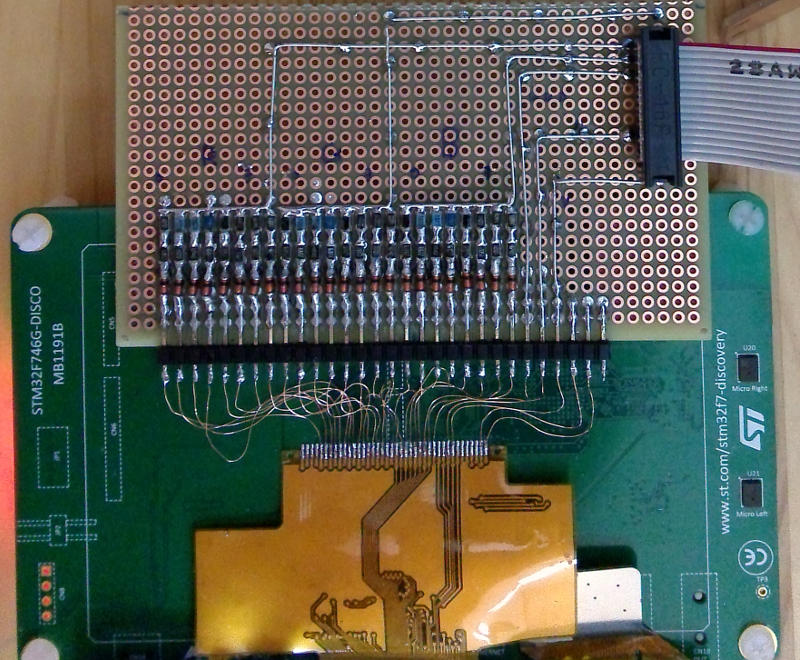

Posted on April 12, 2018 at 12:50
Hi Benjamin,
if you need a Discovery Board with 24 bit TFT Support just try the STM32F746G-Disco :
http://www.dasrotemopped.de/index.php?var=projekte&nr=22
If you do the same trick as with the STM32F429i-disc1, removing the original onboard TFT, you get access to the 24 bit LTDC interface.
http://www.dasrotemopped.de/bilder/stm32f746g-disco_vga.jpg
More challenging to solder than the STM32F429i-disc1, but possible. Also inexpensive with some extra power of an STM32F7.
Happy modding,
Markus
