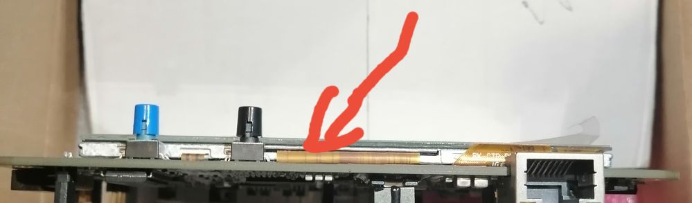

I asked Rocktech about the connectors and their answer is:
"RK043FN48H-CT672B is a custom display only for STM based on their discovery board and the FPC was designed in soldering type, no need connector."
I'm designing custom board based on this development board, and inspecting the side view of the board, I notice the flexible connector underneath the display. My question is how it is connected to the main board? Please see the attached photo.

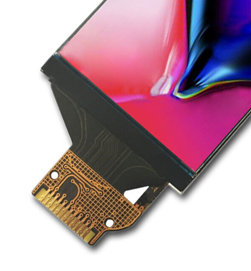

...just for direct soldering, see this 1,8" TFT :
