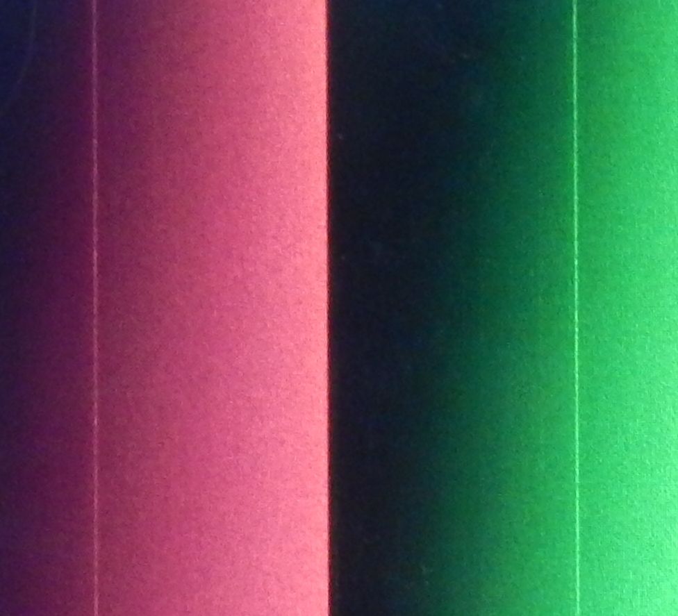

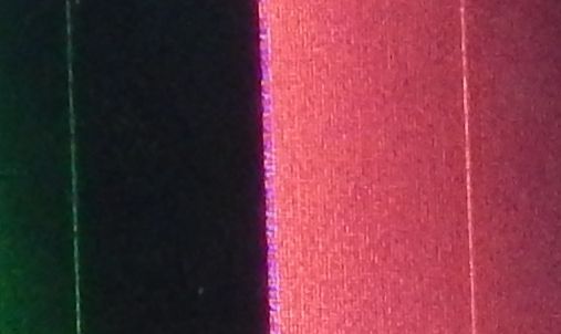

2) when both layers are visible (constant alpha is about 128 for Layer2 - so its stays visible and so do Layer1) I see small vertical lines near painted areas (clear screen and some colored areas just to see whats going on), those lines consist of random colored pixels, looks like noise. I dont think that this is memory issue or LTDC starving for data - pixel clock is only 36 MHz, memory works on 108 MHZ and its 32-bit wide. Horizontal distance between those lines looks very suspicious - i'm not sure, but it looks like 64 pixels... what can be wrong with it? Im absolutely sure that this is not oscillations on bus or something physical.

I have another LCD, 480x272, effect still visible. Pixel clock is 12 MHz (3 times lower than with bigger screen). But this is lesser problem, main is 'why color key is not keying or where i was wrong in my understanding of blending'

?? what graphics? its just framebuffer. Memory region mapped to screen area. You writing to this memory and LTDC projecting its contents to LCD bus according to timing settings and stuff. And its working ok: simple square frame with (255,255,255) color pixels looks great -  no visible jitter, no random pixels. Seems that problem appears when any of color components (only one, two or all three) switching from 0x7F to 0x80 code. If its switching from bigger code to lesser code, threshold is different, but still there - if I draw two rectangular areas, one willed with gray (127,127,127) color and another with (128,128,128), you can cleary see the line of random pixels between them. It may look like ground bounce, but its not ground bounce - board have solid ground plane.
And its not memory glitch too: memory was tested, every single byte, half-word and word with different patterns. I had successful linux boot too, it worked without any memory faults.
I've tested with different sync and clock polarity settings, nothing helps to improve picture. And i'm out of guesses already.

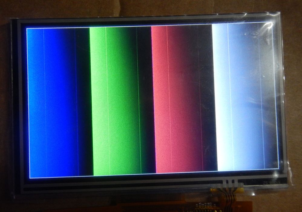

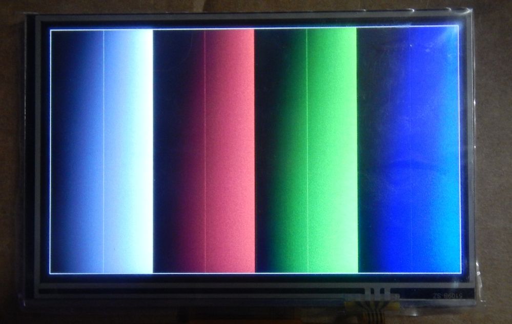

Posted on April 03, 2017 at 21:26
brightness decreasing: two glitches, i guess one on 3/4 and another at 1/4 brightness; and one particular red channel glitching;
whole screen, you see those vertical glitches are on same positions for all 3 color channels
brightness increasing: one glitch exactly at 1/2 brightness
whole screen

well, huh, those nasty electrons... MCU, LCD and my code are proven to be innocent!
I've changed all ceramics around LCD pins and memory bus and voila, magical dissapearance of bus glitches - they all are gone.

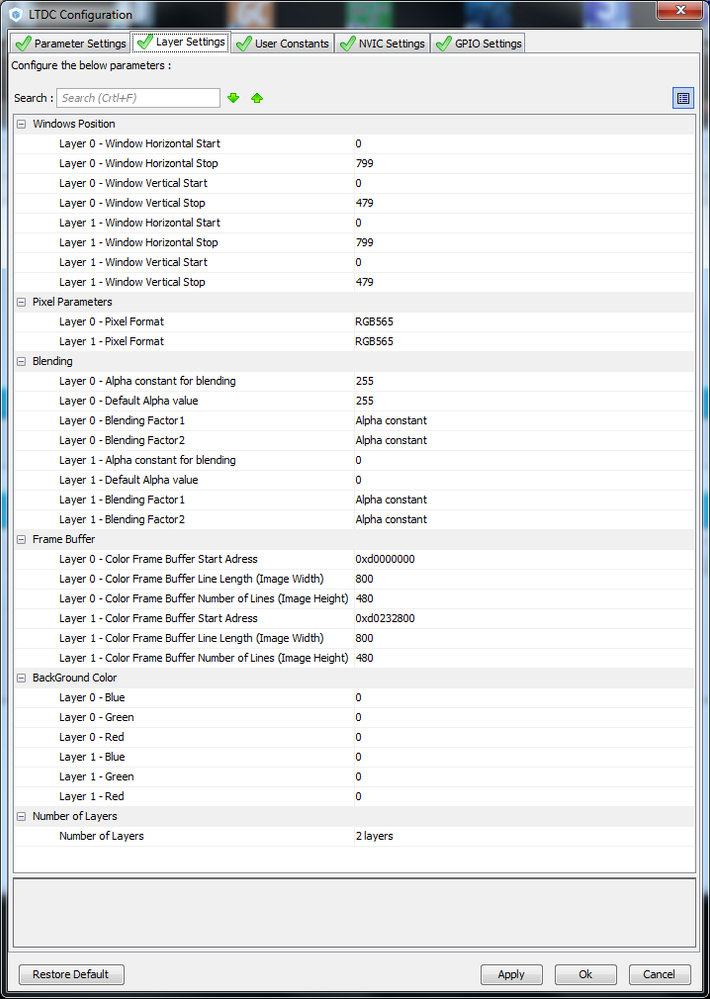

Posted on April 04, 2017 at 21:30
the config of LTDC and Layers, we are discussing TFT display problems. I attached my layer settings for 800x480.
