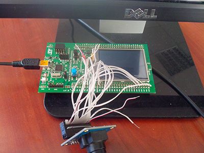

How did you wire the camera. Having a quick look in your code, I did not see how VSYNC is connected.

Posted on August 31, 2015 at 11:06

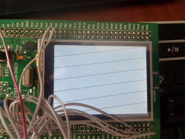

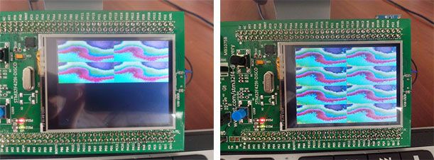

Chuev.Vladimir
Posted on September 01, 2015 at 09:52
I changed I2C array with initialization registers.
Now camera shows small blocks of picture, no fullscreen. And picture became purple.
My code:
    while(1){
        HAL_Delay(600);
        HAL_DCMI_Start_DMA(&hdcmi, DCMI_MODE_SNAPSHOT, (uint32_t)(&OV7670_buffer), (uint32_t)((IMG_ROWS * IMG_COLUMNS * 2) / 4));
