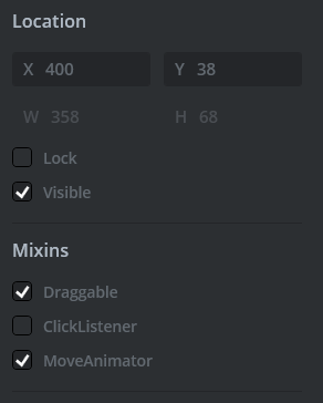

So I have a container with a single image in it. The container is used in a view and has the Mixins Draggable and MoveAnimator ON
Now, I want to animate it from the current position (400,38) to 800,38 so, basically a slide animation. I have a function that should trigger the animation

But I don't see anything moving; why is that?
nico23
Senior III
My bad, I just figured it out that, for some reason, there was an empty override of the function moveRelative in my container class.
Deleting it, the MoveAnimator worked as intended
