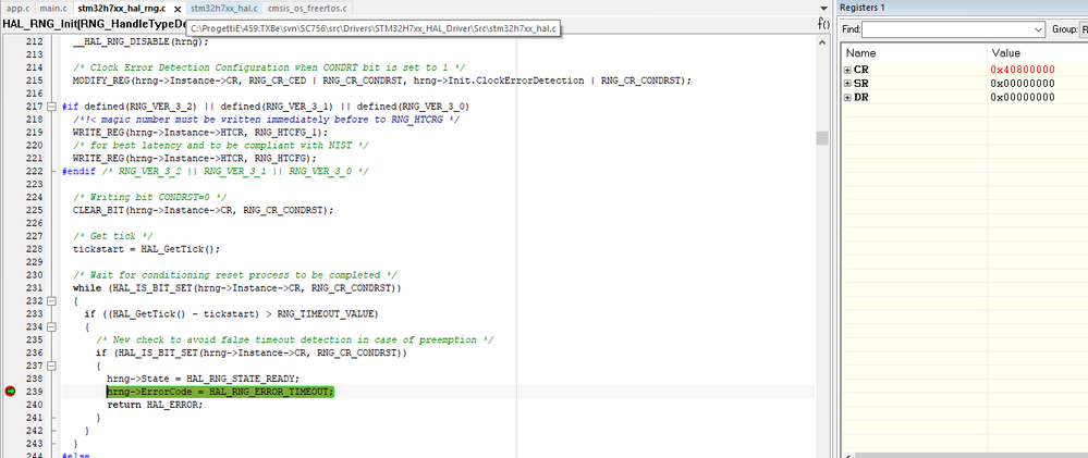

the function MX_RNG_Init fails
HAL_RNG_Init returns t.o.:
while (HAL_IS_BIT_SET(hrng->Instance->CR, RNG_CR_CONDRST))
if ((HAL_GetTick() - tickstart) > RNG_TIMEOUT_VALUE)
/* New check to avoid false timeout detection in case of preemption */
if (HAL_IS_BIT_SET(hrng->Instance->CR, RNG_CR_CONDRST))
hrng->State = HAL_RNG_STATE_READY;
hrng->ErrorCode = HAL_RNG_ERROR_TIMEOUT;
return HAL_ERROR;

Does it need a PLL/CLK running? Are all the registers in the RND, HASH, CRYP zero? Do the clock enables stick low?
‎2022-10-06 7:52 AM

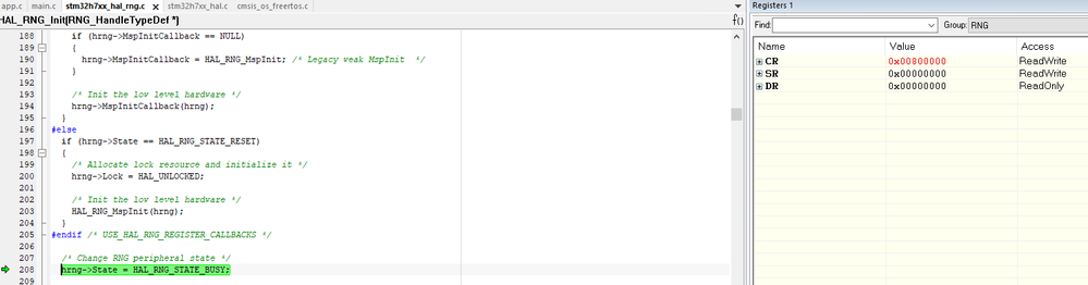

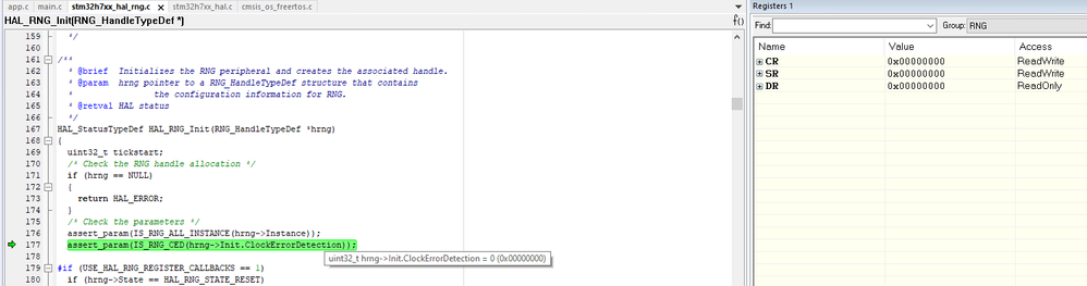

I am using the code genereted by cubemx:
int main(void)
HAL_Init() ;
SystemClock_Config() ;
PeriphCommonClock_Config() ;
MX_RNG_Init() ;
I think that pll and clock are running
The funnction HAL_RNG_MspInit enables HSI48, so also this clock should be ok
Beginning:
after msp init:
here the error:
