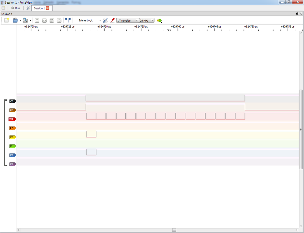

I have the following problem on the micro STM32H743ZIT6:
1) during access to the external write bus, on an SRAM, with only 16 bit bus, occurs when I execute the instruction
* ((uint16_t *) 0x60000000) = (uint16_t) 0xFFFF;
The hardware signals move as follows (/ NE1 yellow, / NOE blue, /WR purple) see attached.
1) It is certainly incorrect because
- /NE1 (yellow chipselect) should only be activated once and not 2.
- And / NWR (purple) should only activate 1 within / NE1 and not 2.
How come this occurs?
Where am I doing wrong ?
2) The above test was performed with the data cache and code disabled, because otherwise nothing is activated.
 How can I write externally with the cache enabled?
Obviously if it's possible.
My InitCode is:

Piotr S
Posted on April 20, 2018 at 16:32
What a coincidence, i posted exactly the same problem today.
https://community.st.com/0D50X00009XkWQESA3
. It looks like fmc tries to write entire 64bit block of memory.
Regarding 2nd question:
I took a look into FMC SRAM code example from cube package for STM32H743I_EVAL, but this example enables data cache, writes only 512bytes of data, then reads it back. Since DCache have size of 16kB, data is not written into SRAM until cache is cleared/runs out of space (which is never). Then example code reads what it just written to cache without single operation on sram. Way to go...
With cache enabled you can force write with SCB_CleanDCache(); I tried enabling cache, writing one uint16_t and cleaning cache which resulted in this:
After cache clean a wholecache line of 32 bytes was written. Not a problem with interfacing to memory, but in my case i want to write commands to LCD with parallel interface.
This leads me to believe that even with data cache disabled there is something between CPU and FMC with cache like behaviour which results in this weird 4 write accesses... Maybe there is something in core or MPU that i'm not aware of.
Piotr S
Posted on April 20, 2018 at 17:41
I believe i have a solution. Put following line at the end of your FMC init function:
HAL_SetFMCMemorySwappingConfig(FMC_SWAPBMAP_SDRAM_SRAM);
Swap your
0x60000000
address with 0xC0000000. Should work fine.
Why this works? Memory under 0xC0000000 is accessed as Device memory, as opposed to memory under
0x60000000
accessed as Normal memory. 'Normal memory allows the load and store of bytes, half-words and words to be arranged by the CPU in an efficient manner (the compiler is not aware of memory region types)'. You can refer to AN4838 and AN4839 for more information.
Posted on April 20, 2018 at 17:33

Hal
Posted on April 20, 2018 at 17:57
My initialization is identical to the one in the example, but I can not try it because I have an FPGA and not an SRAM.
I only have to write words (16bit) to random and non-consecutive addresses.
For me there is a problem in silicon!
Can you confirm ?

Hal
Posted on April 23, 2018 at 09:26
Hi
It seems to work.
Now I have to check if the external SDRAM continues to work
