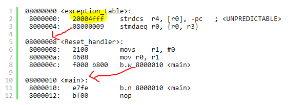

the following is startup.dis
From here you can see the 20004fff, I think it will be initial stack pointer,
But I can't understand the purpose of set the initial SP value to 0x800000.
There is no any action about 20004fff.
Q3, What does 20004fff mean? how and why 20004fff value is in 8000000?

A3: It would be better as 0x20005000, are you using GNU/GCC, because a misaligned stack has a significant penalty on speed. The SP is decremented prior to use. It is a value for top-of-stack placed in the vector table, typically in startup_stm32fxxx.s

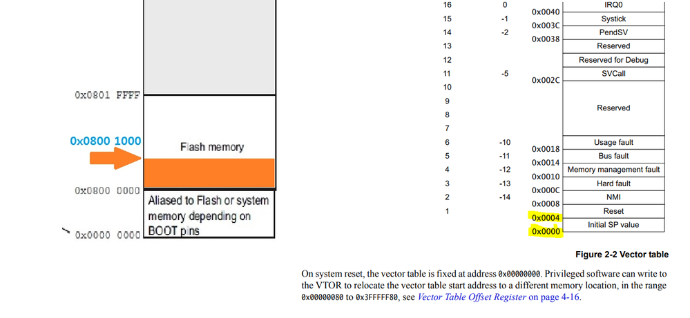

But I still want to know why 0x00000000 is assigned as being Initial SP not the other address?

No, 0x00000000 is not the initial SP, it is the address where the initial SP is taken from.
This happens after a reset, when all internal registers have been set to default, and it is the task of the application program to put a meaningful value at this address.
This behavior is defined by ARM, for all Cortex M implementation. It just has to start somewhere ...
The address 0x00000000 might be shadowed/mapped to other addresses in a vendor-dependant manner.

The Vector Table is a list of Addresses, it provides indirect or vectored behaviour.
The CPU is an automated machine, it wants to do very simple things, at reset it wants to load content for SP and PC registers, and then starts executing.
0x2000 4fff is the value for stack pointer.
why 0x2000 4fff in 0x0800 0000?
when the MCU reset happen, It will fetch the value stored in 0x0800 0000 into the R13(SP),
then It fetch the value stored in 0x800 0004 into PC.
The value as you know is the address of reset handler.
